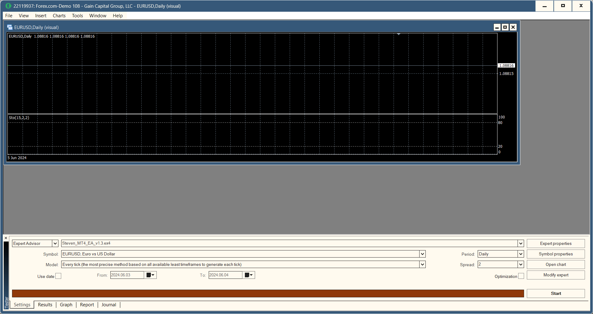

Nothing has worked. I have contacted my Creator as well as my broker. After I have Opened MT4 for back testing. I selected my strategy tester and Selecred Start, a "VISUAL" daily chart for EURUSD continues to pop-up on the screen, but it is blank.
The Bars in TEST (via; TESTER: "REPORT") are the same as The Open OFFLINE Chart.
I can't Figure out what the problem is and It's frustrating me.

I HOPE THAT YOU ARE ABLE TO VIEW THE ATTACHMENT

Re: No daily EURUSD data on my MT4 terminal
Hi Steven,
As always when trouble-shooting, you will need to methodically hone in on what the problem is. If the chart isn't showing, then use the standard "MACD Sample" EA to rule out an issue with your EA. Does the chart show when you test with the MACD Sample EA?

If you're referring to the Visual chart that I sent you the screenshot of Then the answer is yes.
I have Tried it with both the Moving Average (via, MT4) and MACD (via, MT4) With the same result.
So if the chart is showing correctly with the MACD Sample EA, the next step I can say with 100% confidence is to start looking at your EA for the fault. It is most likely failing or stopping for some reason. You need to check the Strategy Tester 'Journal' tab and look for errors and fix them before you can continue.
