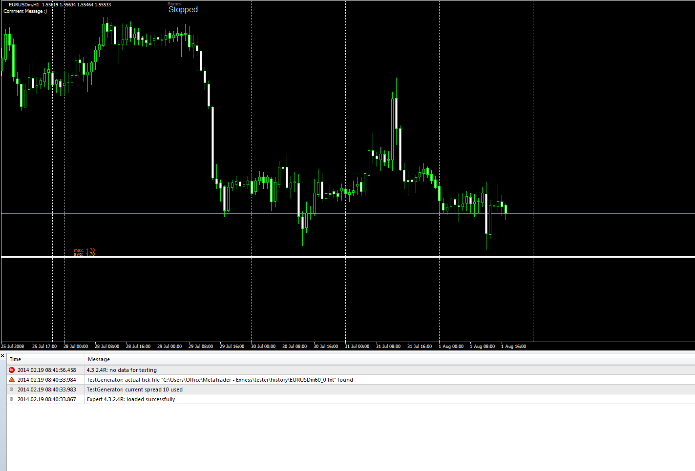

thanks, that's good to know. I did that but the date range listed is shorter than the date range that I downloaded in tickstory. For example, I downloaded 15-minute and 60-minute data for EURUSD from 2003.08.18 through 2014.02.01 and the tickstory window as well as 9Gb file sizes confirms this. However, in mt4 offline data it shows same start date from 2003.08.18 but earlier end date to 2008.01.18. In attached screenshot, chart goes until 2008.08.01, tester template does not load and journal says "no data for testing". Any ideas? Thanks :)
Re: Cross-Timeframe Calls
Hi Trader2384,
There is an MT4 limitation of how large your exported file can be. Please refer to this post for more: http://www.tickstory.com/forum/viewtopi ... 348&p=1448
