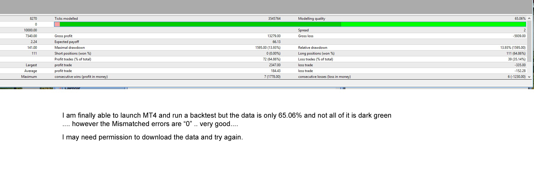

Thank you for your response again ...
I am now able to "Launch MT4" and run a back test .. However the data is not as good as it should be. The modeling ran at 65% ... See attached JPEG file ... I may need to download the data again ... What do you think?

Good to hear the launcher issue is fixed, but it still looks like there is an issue. Until you are getting 99% modelling quality, it means you are not using tick data. Please check out our FAQ for possible causes of this issue:
https://tickstory.com/help/tickstorylit ... ng_quality
As before, if you have any issues, please send us some screenshots (it's likely that you have not 'Mapped' your symbol correctly from the Tickstory symbol name to the exact MT4 symbol name, so make sure you have done this - there is more information in the user manual).
