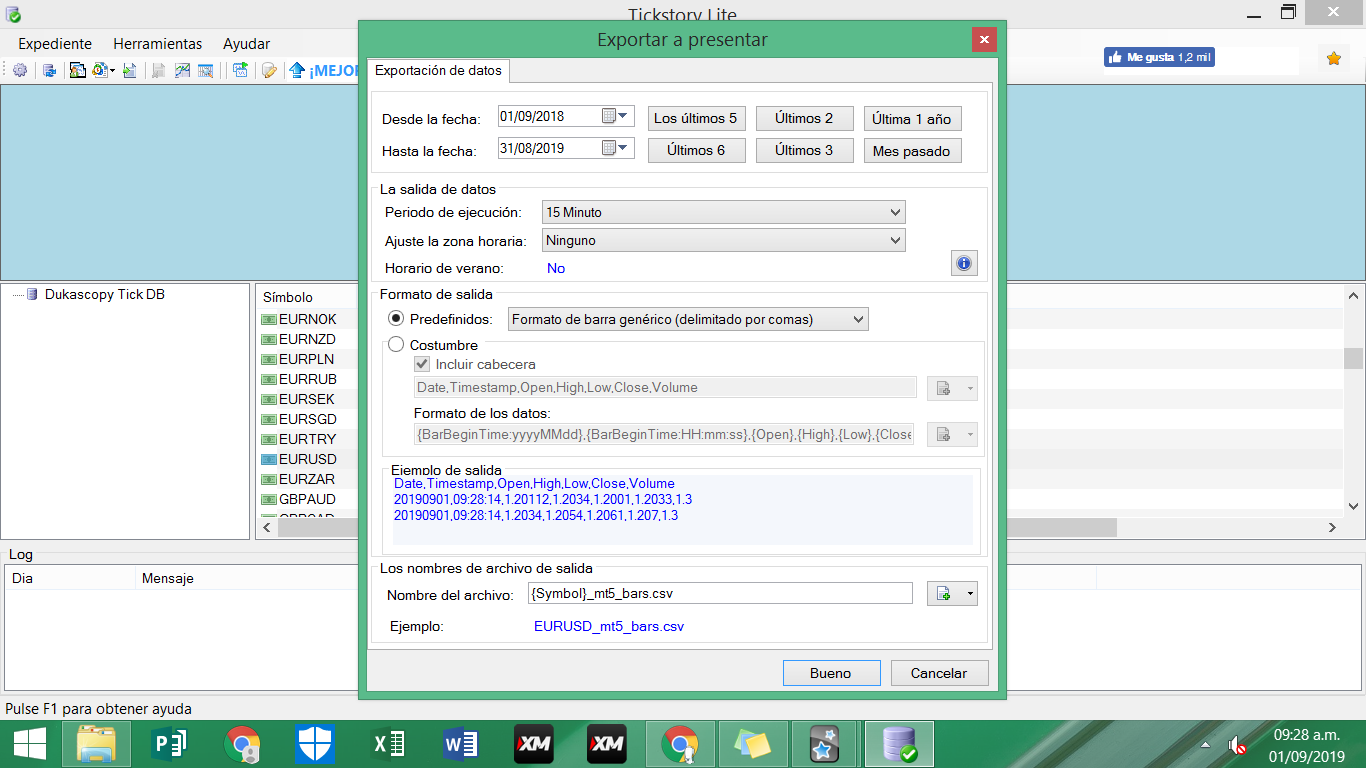

Hi, when I want to export the file to MT5, I follow all the steps in the user manual, I get to download the file but it's in excel format, not CVS, so my platform is not able to import it. What am I doing wrong? I attach an image if it helps. Thanks

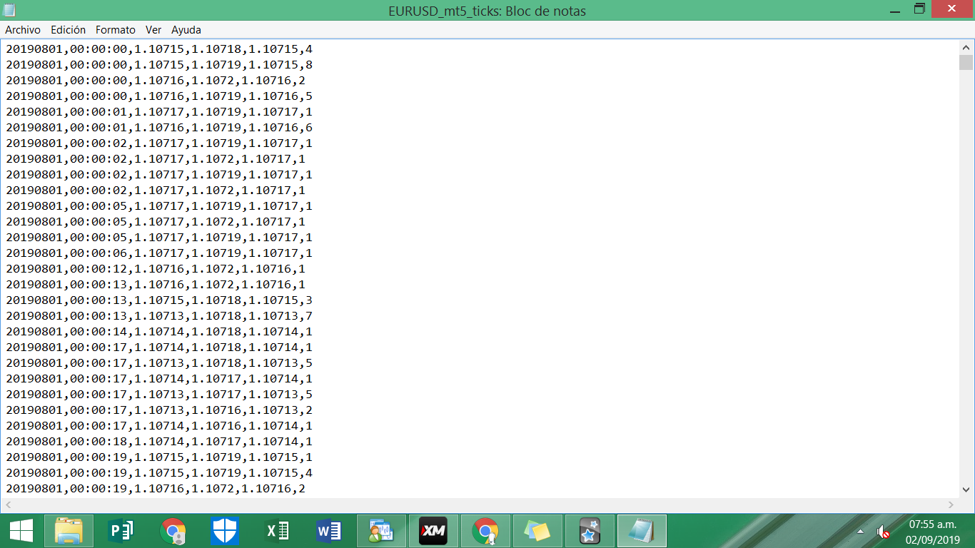

I've opened it with a text editor and this is what I see (image attached). But my platform is not able to read it.
How can I import it to MT5?
Thanks again

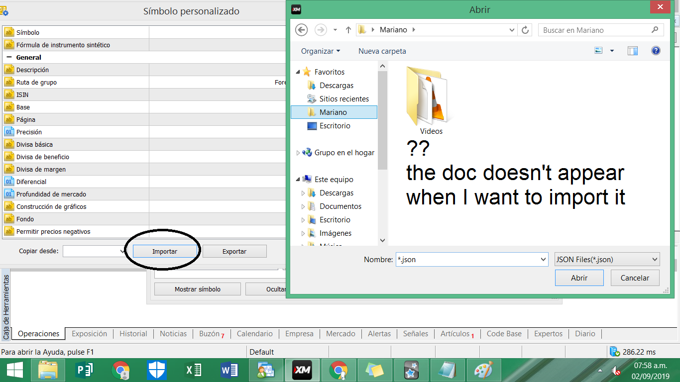

Re: Problem exporting file to Metatrader 5 (MT5)
Hi Mariano,
It looks like you are trying to import symbol settings (note the *.json file specification) instead of importing tick/bar data (*.csv). Please check out our guide here which describes the import process in detail, including a video:
https://tickstory.com/how-to-import-tic ... atrader-5/
