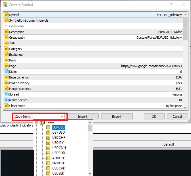

I have downloaded the USA30 tick and bar data as per the helpful guide on your site.
However, when I am creating the custom symbol for Dow Jones on MT5, I am having issues with getting the correct contract size and therefore position sizes when conducting the backtesting.
How can I find the correct specification to use?
Metatrader5 USA30.IDX Specification
Re: Metatrader5 USA30.IDX Specification
Hi Beam30,
In Metatrader 5, when you "Create Custom Symbol" (in View->Symbols), there is a "Copy from" option as shown in the screenshot. This will copy all the instrument specifications.
Thank you - it is working now.
