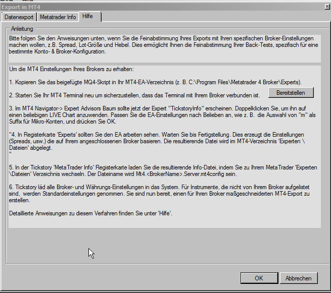

Besides, in your document about "Generating settings from your own broker" it tells:
1. Click on the “Help” tab within the Tickstory MT4 export dialog. This will give you the same instructions as described here about how to deploy the Tickstory EA to your MT4 installation.
Where is the "Tickstory MT4 export dialog"? Is it the "Export in MT4 ..."? Here is what I see by me. It is in German.

Re: Does TickStory-Lite v1.5.3 support MT4 Build 1090?
Hi Thomas,
It is recommended to disconnect from your broker since MT4 sometimes tries to back-fill data which isn't as complete as Tickstory's. To disconnect from your broker, simply go to File->Login and enter an incorrect password. Please note that best practice is to reserve an MT4 terminal specifically for testing. This will ensure you can continue to use your demo/live terminals.
Re: customizing settings, please ensure that you are getting 99% modelling quality first since this will confirm that all your export and launch steps are being done correctly. Once you are familiar with the export process, you can customize your settings as described in the Help tab (shown in your screenshots) or referring to the manual and/or forums.
