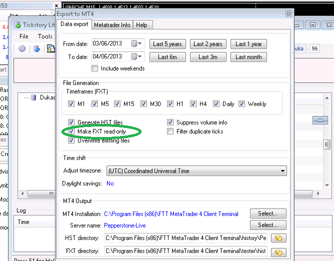

I've download the data as the "tickstory help" webpage guide, and i've done the "export to MT4",

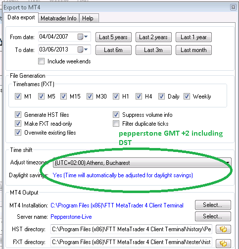

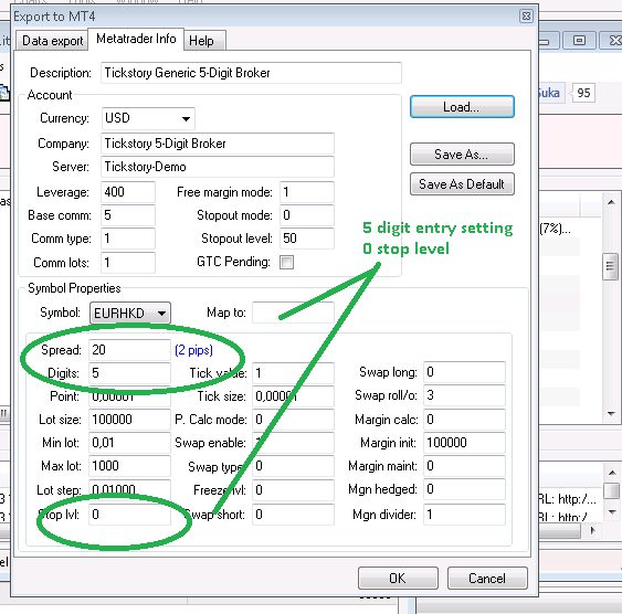

so it might be used like this for the setting :
GMT n DST Setting
And this for The Curency pair setup, 5 digit

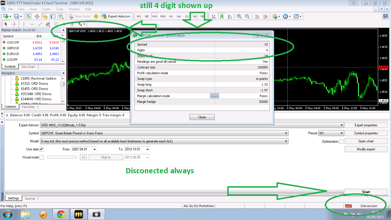

But what ended up, i got result with 4 digits data in my MT4
Oh ya, and all the Modelling quality i got is N/A.
Im pretty sure its the data that i've download with tickstory and sent to my mt4, since the starting and ending date for all data is all the same. And im emptying my pepperstone history folder totally before doing the tickstory steps. Also always disconected from the server and launched the MT4 trough the F8 from tickstory tools.

Thanks for the detailed info to help us troubleshoot your issue. With regards to the Number of Digits, it appears you have correctly created a 5-digit extract which is good. The reason why MT4 displays "4 digits" is because this information is obtained directly from the broker - not from your exported database. If you wish to double-check whether your back-test if using 5-digits, you can print out the variable "Digits" in your MQL code.

I've checklisted the setup for Read Only
And always do the method disconected from the broker
But still shown 4 digit, even i drag the symbol to the chart it is 4 digits.
Im sure im doing by F8 for launch MT4
And about the disconected, i didnt conect to my broker because my broker automated reject me and give "Old Version" in the bottom right my MT4 that shown in picture.
Or maybe i should disconected by using fake proxy in my MT4?

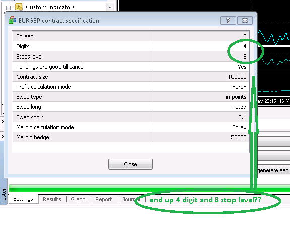

Oh ya, im sure its shown as 4 digit, because im doing backtest and the price shown is did 4 digit.
Please advice

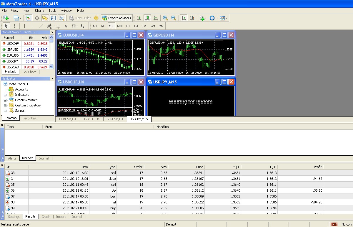

I've just backtested my EA using the build 432 suggested on this forum and see the opening prices being in the 5-digit format while the SL/TP values are in the 4-digit format. How do I get the SL/TP values to be in the 5-digit format too?

My EA was actually designed for 5-digit brokers yet the chart pricing and the SL/TP values of your build 432 are 4-digit - kindly refer to my screenshot above. Do you have MT4 build 432/445/451 with 5-digit pricing?
