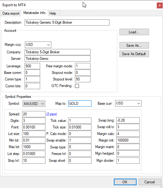

How to setting download GOLD for XM broker.
I have try as pic it's not work.

Hi Sattaya,
I'm not sure what you mean by "not working", but could you please do the following:
1) Save the attached .mt4config file to your Documents folder (this file was created using the process described here: https://tickstory.com/forum/viewtopic.php?f=2&t=809).
2) Close your MT4 terminal if you currently have it open.
3) In Ticktory, select XAUUSD for "Export to MT4".
4) Select the dates you wish to export (just select 1 year for testing purposes, you can change this later)
5) In the "MT4 Export Settings" tab, select "Load" and then select the .mt4config file you saved in Step 1.
6) Press OK to begin the export.
7) When the export is complete, press the "Launch" button in Tickstory to start MT4.
8) In MT4 Strategy's tester, select "GOLD" as the symbol, uncheck "Use dates" and select "Tick" modelling method. Then Start the back-test.
9) When the test completes, you should get 99% modelling quality.
Please let us know if you have any further issues.
