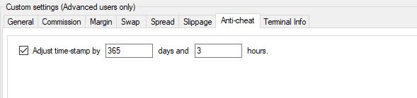

Re: Add new export data feature option to detect dishonest EAs
Hi Srormex777,
Good news - as of the recently released v0.0.4.48, the Advanced Tester now supports the ability to shift the timestamp passed to an EA by x days and y hours. The change has been implemented such that you don't need to export data each time, just tweak the settings and the data sent to the EA will be changed accordingly.
Please check it out by downloading the latest version.
Thanks again for your suggestion!
