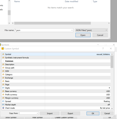

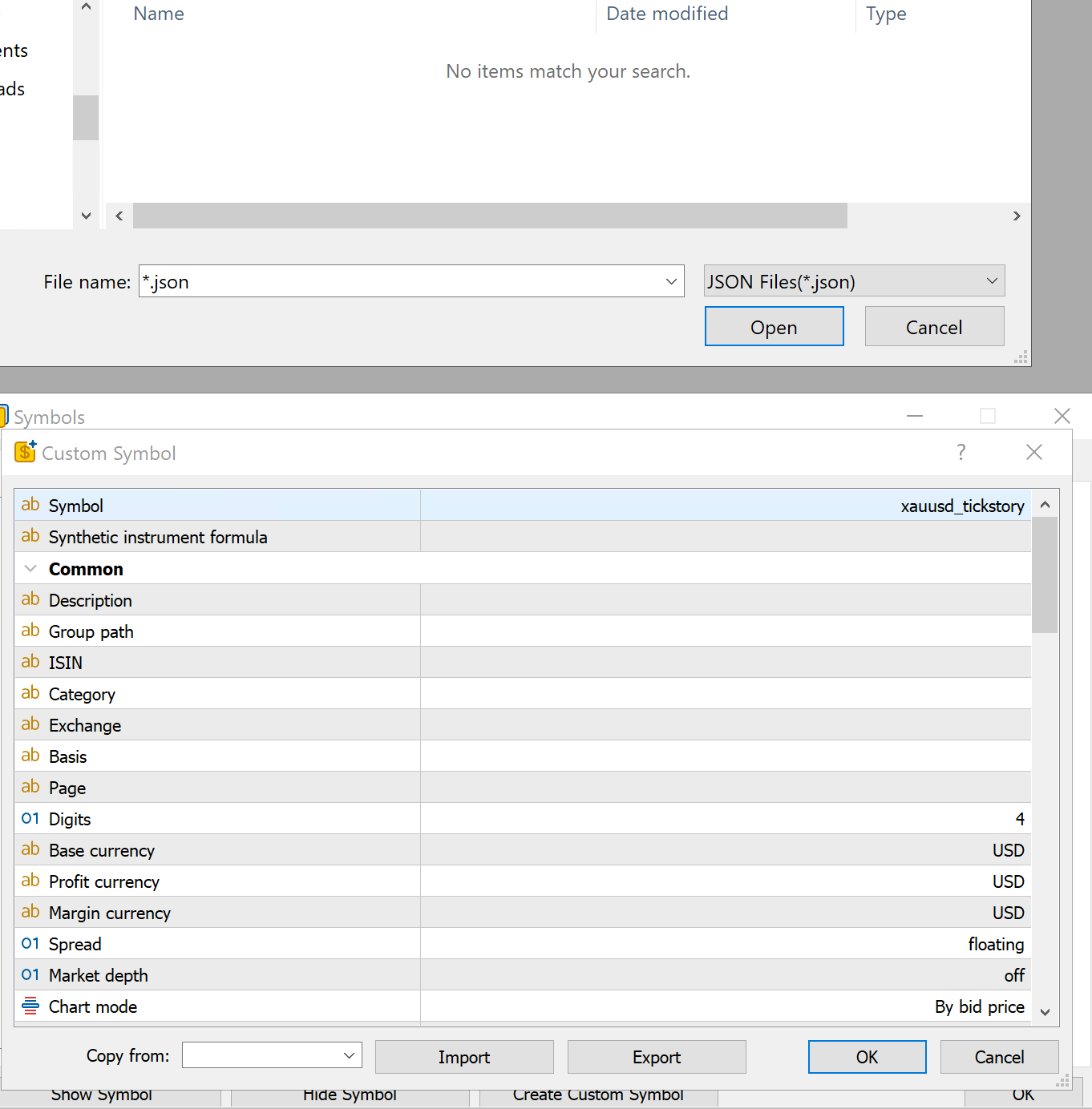

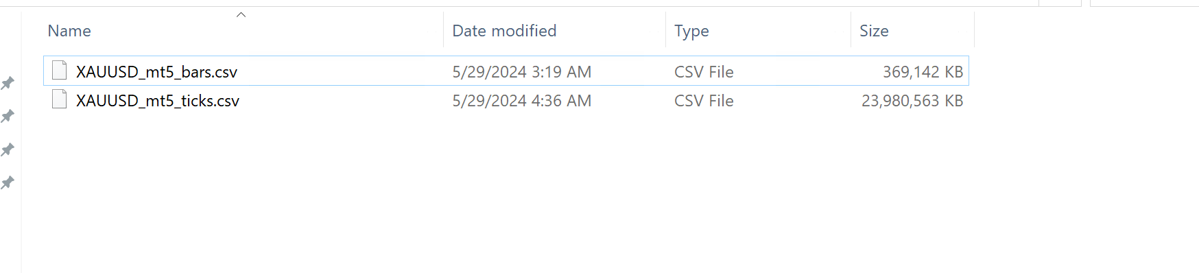

i'm facing issue as this is my first time to import tick data on mt5.
i finished step 1 & 2 but on step 3 when creating custom symbol and click import data i can't find them although if i open the location i see them the bars and tick files but through mt5 terminal they don't appear.
what did i do wrong if thats the case?

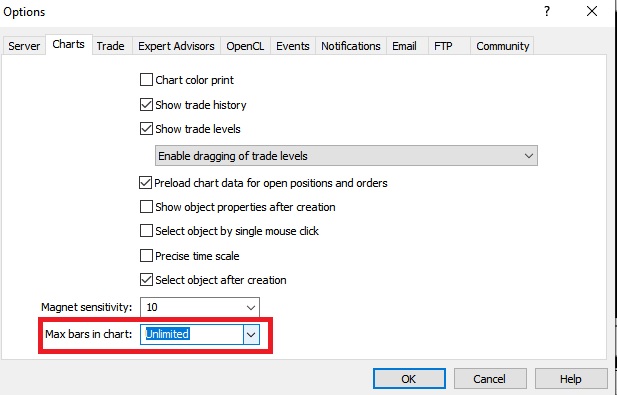

Hi Tickwaiting,

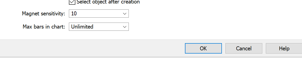

If you are referring to not being able to see data in the "Bars" tab when requesting a date range, please make sure you have gone to MT5's Options->Charts->Max bars in chart and set it to "Unlimited". If you don't do this, MT5 will not show all available data to preserve memory resources.

hi tickstory
i changed it to unlimited still not appeared, i guess i have to delete downloaded files and start all over again, then i will update you if it is solved.

Hi Tickstory,
this issue still present, kindly see screenshots 1-4

Hi Tickwaiting,

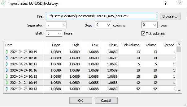

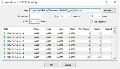

Could you please elaborate what the issue is from the screenshots you provided? Just one point to add and that is, have you tried the "Copy from" field to copy all the data from an existing MT4 symbol? This will allow you to duplicate all the existing symbol parameters without having to import them via a .json file.
After that, could you please tell us what the issue is? When you import the data on the "Bar" tab, do you see the imported sample as shown on the attached screenshot?

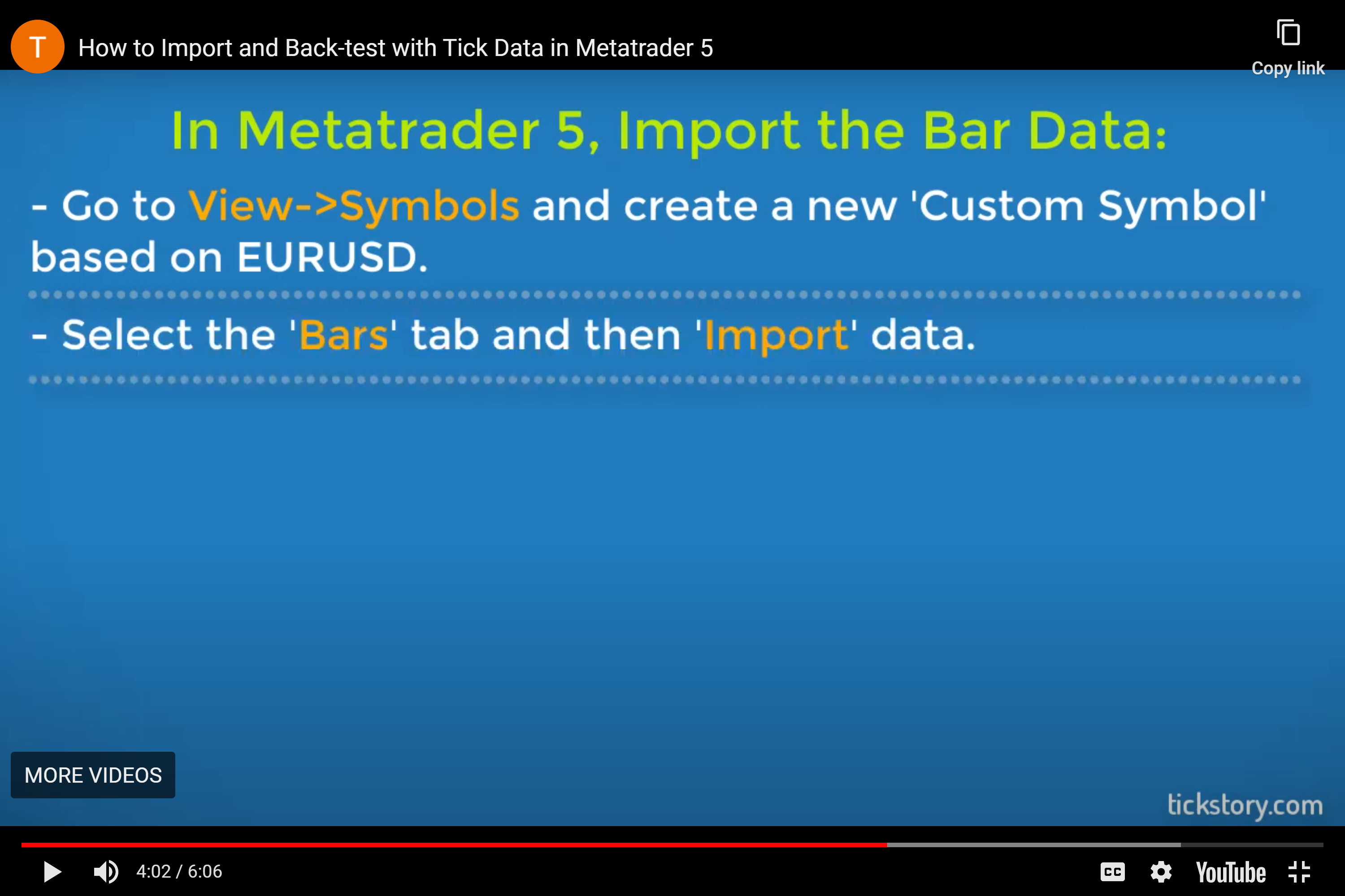

im not sure if we are on the same page.
i use mt5 not mt4 i followed the instructions on this video but stuck on step 3 which started at 3:49 it shows instructions without image.
https://youtu.be/a1ZehpsSqvo
when I create a custom symbol then click import i don't see the downloaded data
if it's possible you make video or screenshot of step 3
thanks

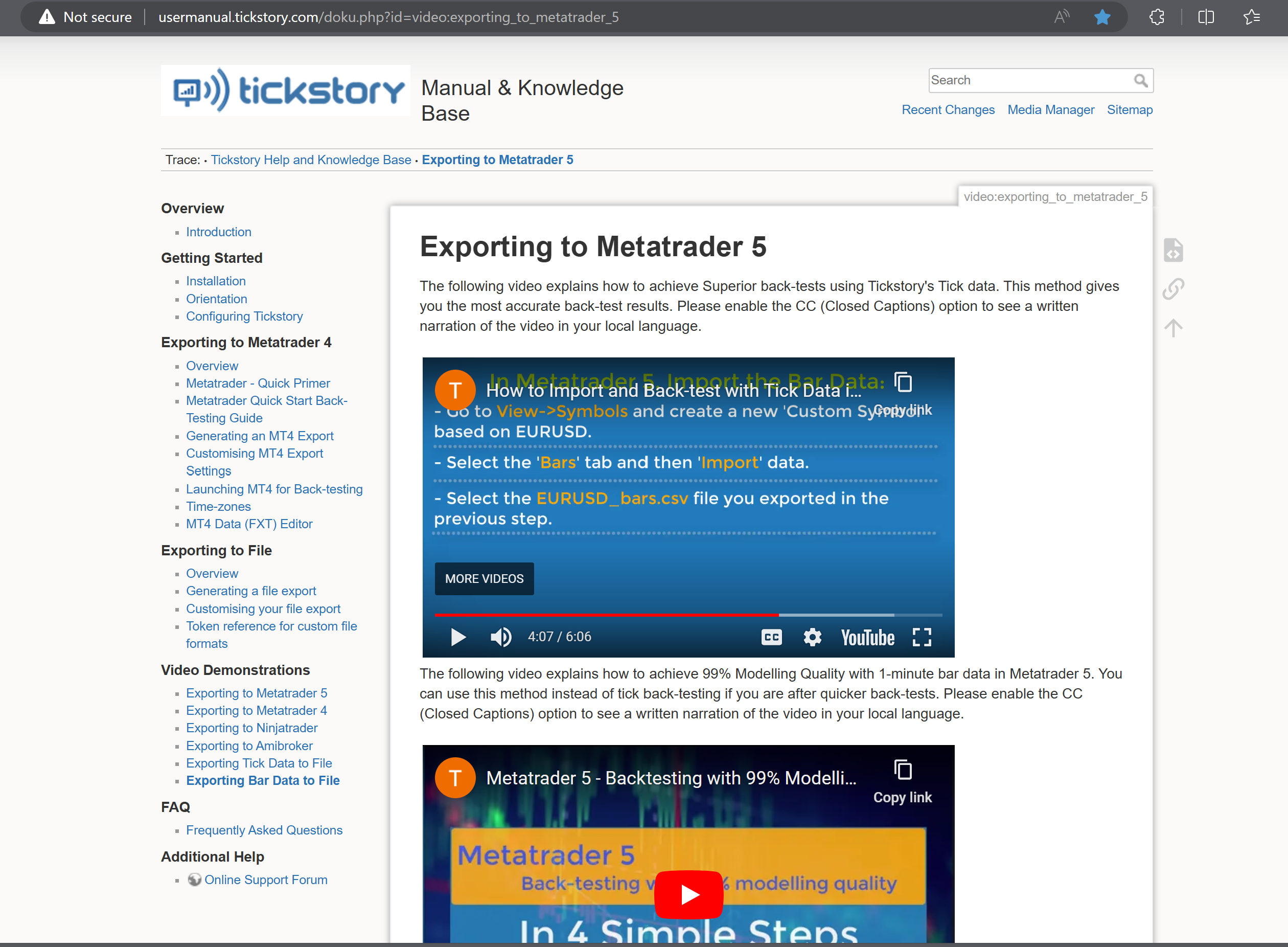

Re: mt5 import data issue
Hi Tickwaiting,
Yes, apologies we cannot provide a video of MT5 screens in Youtube due to copyright issues. Our associated guide which is linked to in the Youtube description goes through everything step-by-step with screenshots. Please let us know if that doesn't clarify.
