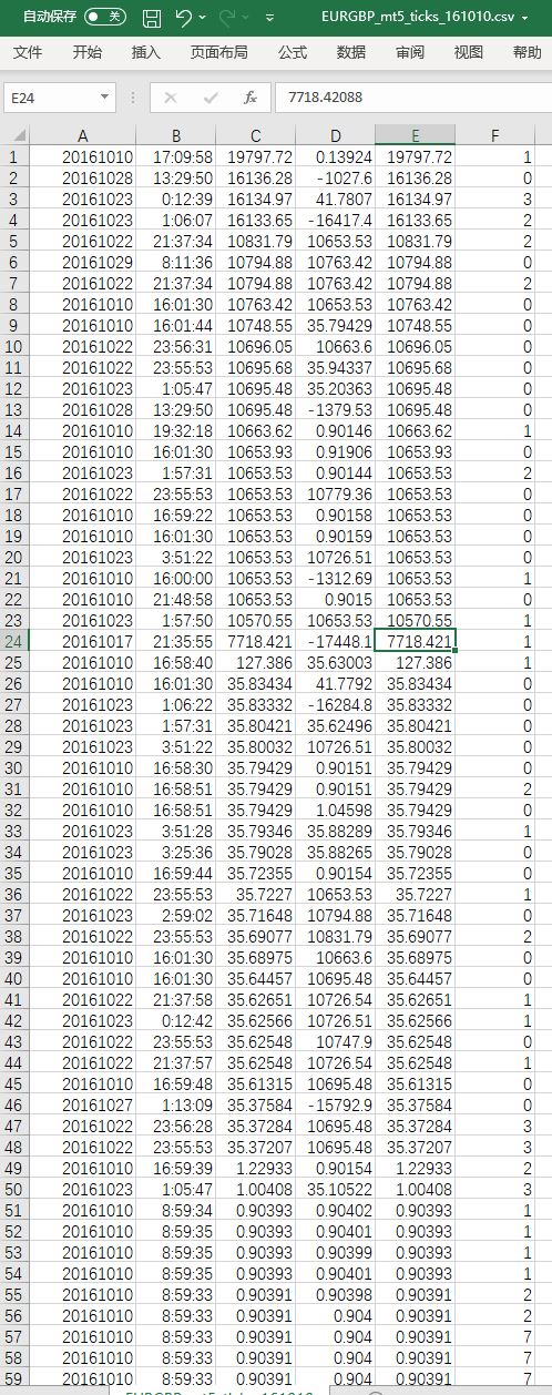

Hi, I found EURGBP tick data on 2016-10-10 must be wrong, because it is much too high, and it breaks all my strategy and possiblely keeping me from exporting M1 data.
So what can I do to fix this?

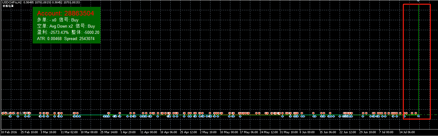

Wrong data for USDCHF again... Any suggestion is welcome.
Re: EURGBP tick data error
Hi Adamwu,
The numbers shown in your Excel screenshot don't look correct at all. These are not the numbers that Tickstory generates on our side. The timestamp seems out of order (cell sorting?) and the prices are way out (should be ~0.9). To discount that your spreadsheet is formatting/changing the numbers, you should look at the raw output in Notepad and cross-check your values in Tickstory's Data Inspector.
