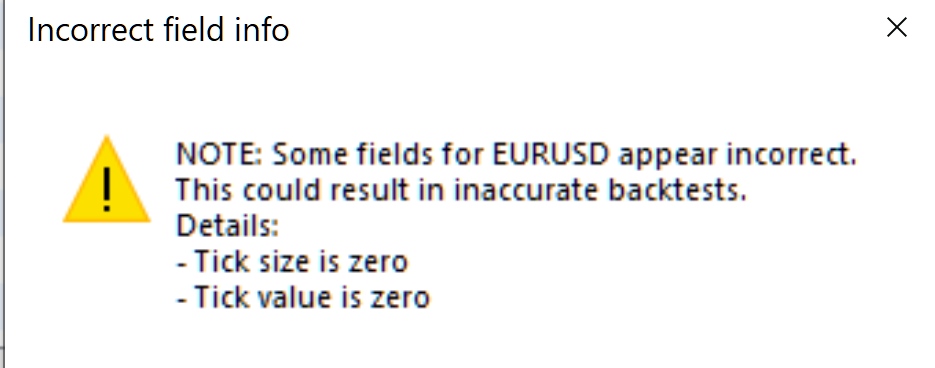

Thanks, I followed these steps very carefully and saved them as default in tickstory. And I reopened tickstory and when I tried to right click to the pair > export to mt4 I get the error in the image. When I check the symbol properties in MT4 I see that tick value and tick size is 0 too. So I guess I can ignore the error right? Or does it mean my broker is hiding this info? (By the way when I use MQ4 script to load symbol properties I get different values. Tick size etc are not 0)
Re: How to test with AT and variable spreads
Hi Gu00hero,
Yes, please ignore this notification. The tester in MT4 automatically assumes a value of these settings if they are not in the instrument specification. You will notice that when you print out the tick value and tick size in MQL, it will likely come out as "1" and "0.00001" for EURUSD, respectively.
We're reviewing whether this notification should still be present, as it originally was useful for people manually inputting these numbers.

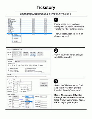

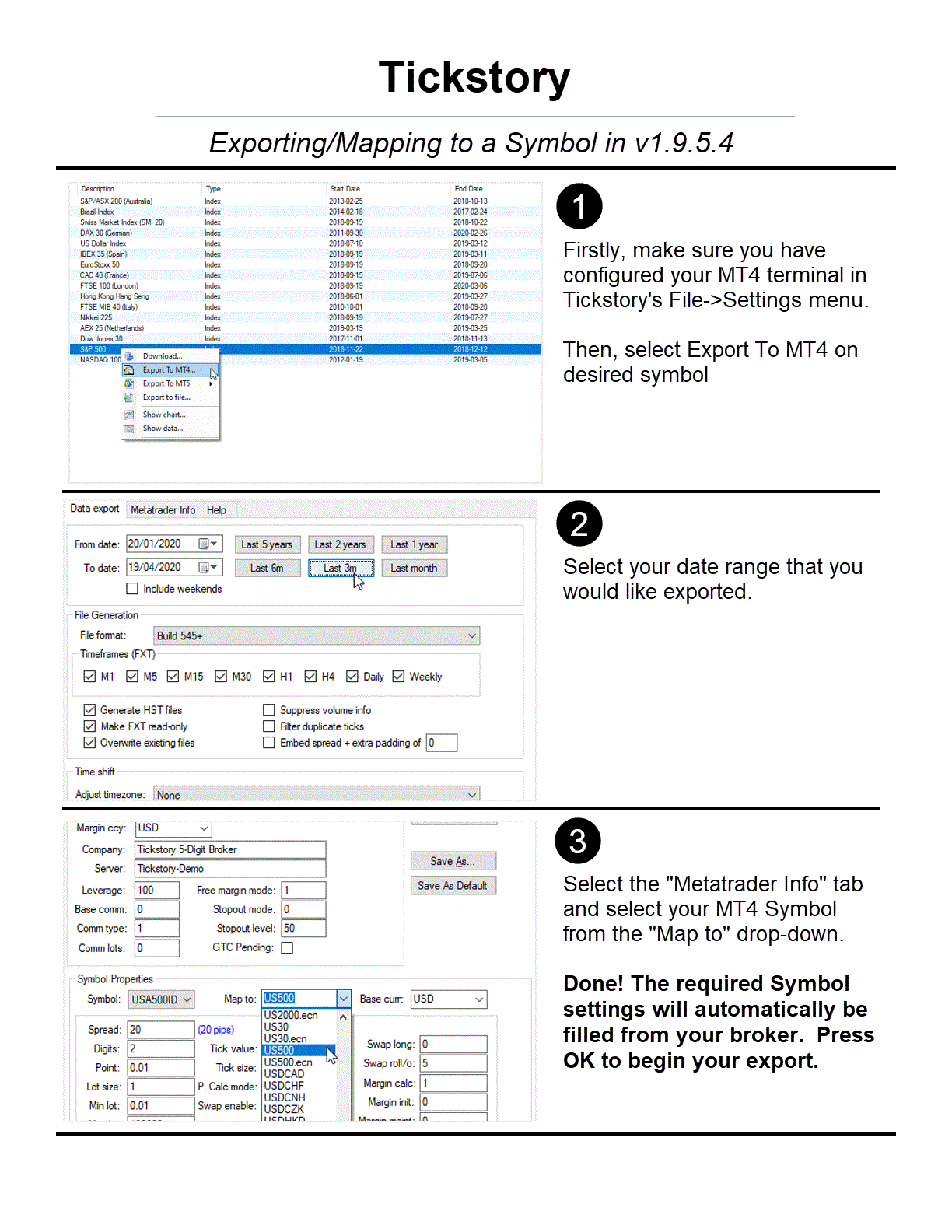

hello there,
Is it necessary to click Embed spread in tickstory for the advanced tester variable spreads?
Another question how can i access the in 2c described Map to feature in mt4?
Hi Tradingdelightful,
Yes, it is necessary to embed spread information when doing your export. Technically speaking, the MT4 file format does not contain bid/ask information so this step is necessary if you want to test with variable spreads.
Regarding the "Map to" feature, please see the attached slide to show how to select your symbol. This information is also available in our Help Manual.
