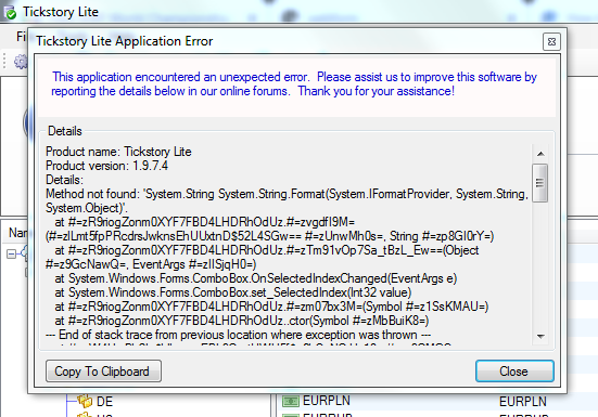

hello,
try to free version and following the video instruction to backtest.
but found this issue, what should i do ?
Re: Error "Method not found" when using Tickstory
Hi Darrenfx,
Please make sure you have .NET v4.6.1 installed on your machine (download and install the runtimes). The issue you mention is usually caused by the .NET packages not being installed or corrupted.
If you are continuing to have issues, could you please send us the actual text of the error ("Copy to Clipboard") and tell us what you are doing to invoke the error?
