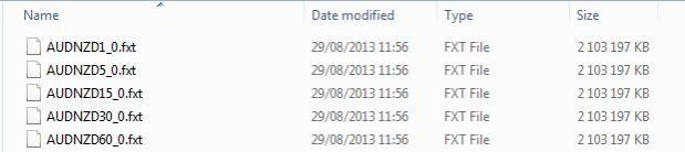

I launch MT4 using ticktstory for preventing history files overwriting. History files look ok in tester/history folder:
