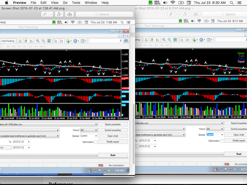

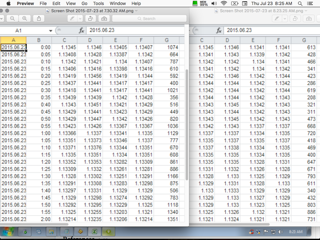

I did two tests, one exporting with filter duplicate ticks unchecked and one with it checked. In both tests, Suppress volume is unchecked since this is what we want - volume in our backtests. I exported last month of data EURUSD and used M5 in my backtest (even though Bill Williams only uses Daily charts, I wanted to get quicker results so backtested a lower timeframe just to see if the EA traded per rules like it is supposed to, per my understanding of Bill's rules). I got two different results when I backtested. I checked and saw that in History Center that the Volume column was different for each one. I saved as cvs out of MT4 the visual backtest charts and opened in excel. I took screen shots of the excel files and the charts. I placed the first set on the left and the second set of test chart pic and excel file on the right. You can see the differences and yes it makes a difference in backtesting.

First backtest with Filter duplicate ticks unchecked on left. Second test with filter duplicate ticks checked on right.

Note that in last test, I mad the maximum of the MFI indicator to be 0.01, because there are times that the blue bars are so tall that the other bars aren't able to be seen, so I limited the height. Also note that the indicator bar height aren't as important as the colors of the bars, and the colors of the bars are different depending on what setting is used in Tickstory and volume we get in History Center.
