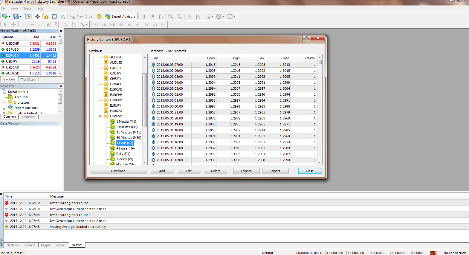

Still get the error, I added a screenshot of what I see in the history center. I downloaded the data on the 27 the of november for the last 5 years. It also only shows me the data from the 27th of november 2008 until the 3rd of june 2013, maybe there went something wrong with downloading the data as it seems not all the data I wanted to download is downloaded?

Re: Tester: wrong bars count 0
Hi Magi,
Thanks for the further details. Could you please check your FXT size and ensure it is under 4gb. There is a limitation with MT4 that is can't process FXT files larger than a certain size - see here for more information: http://www.tickstory.com/forum/viewtopic.php?f=4&t=202.

The size of my FXt files is 4,194,300 kB, so this might explain the problem?
