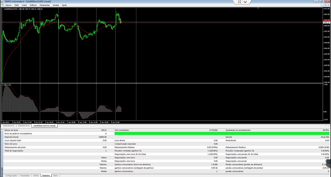

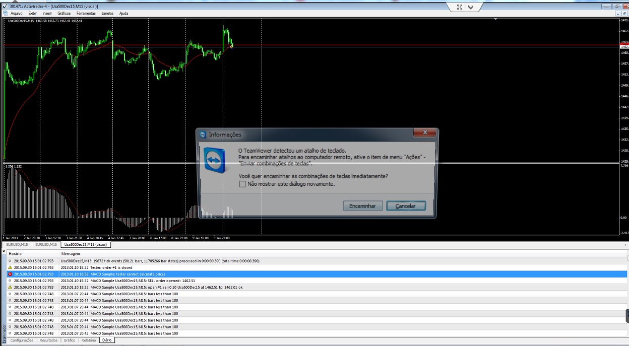

While every procedure in Forex pairs, all OK. But with the SP500 still problems.
The MT4 do the tests, but it crashes in the first operation and ends the backtest.
I am attaching pictures of configuration and MT4 messages.
What might be happening?

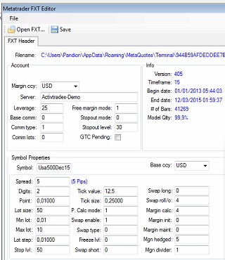

I did all the procedures as described in the link.
Does not work, copied to the FXT equal the broker and the problem continues.

We've loaded the ActivTrades and can't see any symbol called Usa500Dec15. Could you go to Files->Open Data Folder in Metatrader and zip up your "config" folder and send us the zip file via PM?

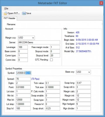

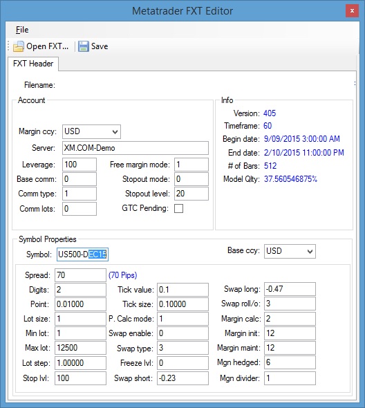

We have tried to replicate the problem under an XM.COM terminal which has the instrument "US500-DEC15" but had no issues. Attached is a screenshot of the native broker settings for this terminal. Perhaps you can try copying the settings verbatim and seeing if it resolves the issue. Otherwise, maybe you can use the XM terminal first to narrow down the issue.

Hi Pandion,
I assume that you're still getting the "Cannot calculate prices" error? Or has this been resolved after copying the above-mentioned settings?
We took the following steps to back-test S&P 500:
1) Download demo MT4 from XM.COM. Run it once and log in. A symbol called US500-DEC15 should exist in this platform.
2) In Tickstory File->Settings->MT4 Settings, set the path to your MT4 Installation folder.
3) In Tickstory, select the instrument USA500IDXUSD, right-click and Export to MT4.
4) In the "MT4 Settings", copy all the details from the screenshot in this thread. Set the "Maps to" field to "US500-DEC15" which is the name of your MT4 symbol.
5) Select the dates for export - just start with the last month to keep things simple.
6) When done, Launch MT4 with Tickstory (press F8).
7) Select the US500-DEC15 instrument in the Strategy Tester. Select the "MACD Sample" EA for testing.
8) Start the test.
Hope this resolves the issue for you.
