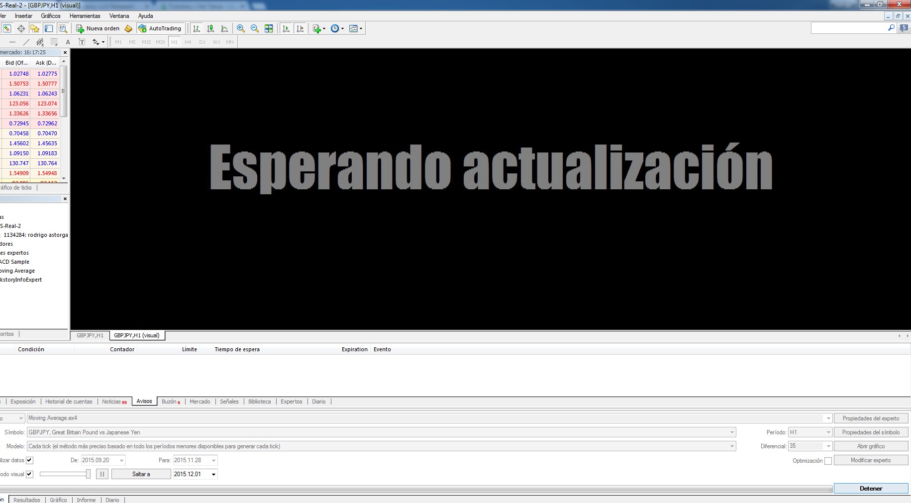

El problema que compre la hace unos dias la 1.72 , la instalamos como siempre , descargamos como siempre , el problema que ahora al momento de por ejemplo hacer un backtesting queda pegado en la tipica ventana esperando actualizacion.}

Hi Rodas,
Are you using the latest MT4 Build 920? If so, MT4 have issued a breaking change which we have had to address. As a result of this change, you will need to upgrade to the latest v1.7.3 of Tickstory. This is a free update and is available from the original link you were sent on purchase. You will also need to re-generate your exports to resolve the issue.
In the future, it may be worthwhile using the "/skipupdate" command-line parameter (File->Settings->MT4 Settings) to ensure MT4 updates do not disrupt your back-testing, This way, you can schedule an appropriate time to upgrade.
