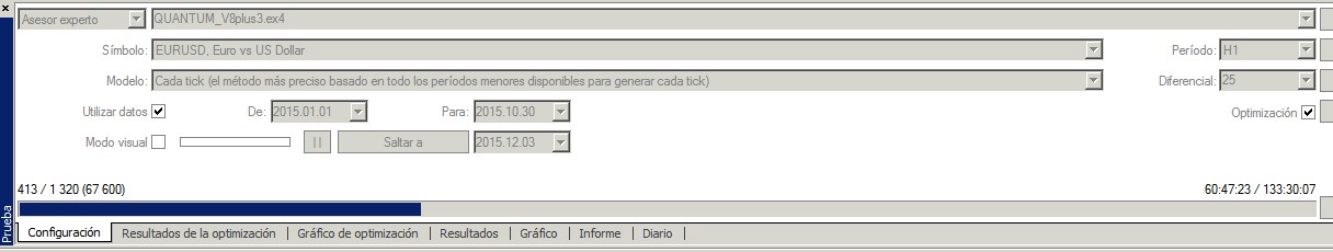

Tickstory not saying it can be a factor, but I have noticed that since version 1.72 and now 1.73 optimizations have me slow at first and start well but when he pulls a few results are much slows down and spreads many hours to complete the process.
I'm taking the same EAS as before, the same pair, same time frames. All equal. I tried on different computers, I have also 4 vps and all the same.
What could it be? For example we see here in the picture is supposed to optimize will finish in 130 hours more and I've been 60, before this I did in 50 hours 80 hours approx.

The only changes made to Tickstory between v1.7.2 & v1.7.3 is the support for the latest MT4 Build 920. Tickstory does not perform any optimizations/back-tests itself and we have made no changes that would affect the speed of this functionality.
At this stage I highly recommend that you revert back to MT4 Build 910 if you are having problems with Build 920. It seems numerous people are having problems with this latest version.
You can read more about how to revert back to Build 910 and stop MT4 automatically updating here:
http://tickstory.com/forum/viewtopic.php?f=2&t=876
