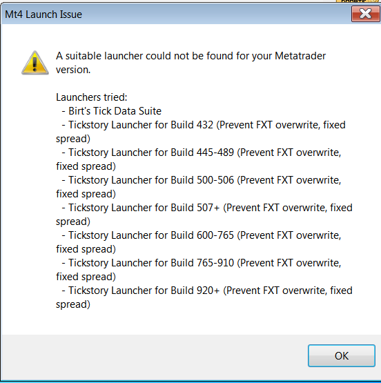

Today I've bought your last version. I've downloaded EURUSD data but when i try to launch MT4 appear the attached window
does it indicate any problem with the export data?

Re: problem with release 1.7.3 and MT4 build 920
Hi Newdreams,
The launcher error does indicate something has not been set up correctly (although your data export sounds fine). Please follow the check-list in our trouble-shooting guide under the question "I am getting a launcher error" here: http://tickstory.com/forum/viewtopic.php?f=2&t=613.

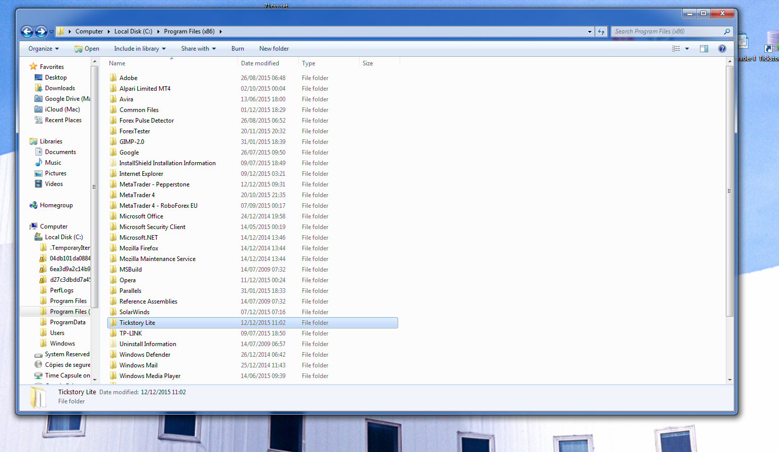

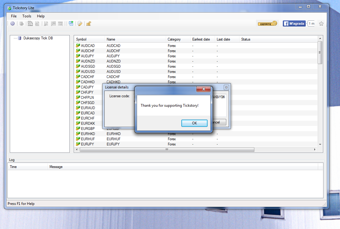

1. First I tried the free version (lite) and then I bought the full version,I installed the full version from the link you sent me by e-mail. But The icon on the desktop and directories created appear "tick story lite". I think I've entered the activation key correctly.

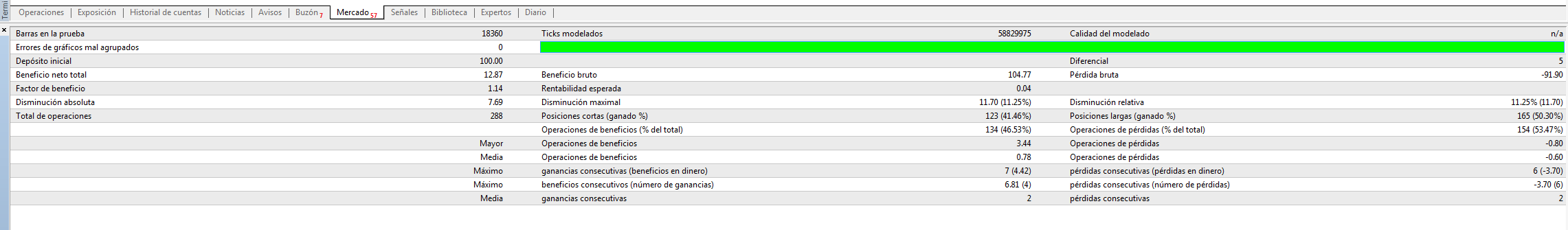

2. When I do a backtest, in the final report, the quality of the model is "s /n", but the bar is completely green.

After the update of MT4 to 940 I see now every time with TS v 1.7.3 (see attached screenshot). Could you fix this and release a fix to allow the loading of 940? Or is there a beta version we can try to overcome this issue? Thank you.
Hi Lenny,
