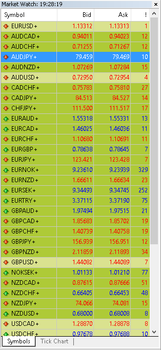

My broker have a subffix of "SPACE+" on symbols, see this:

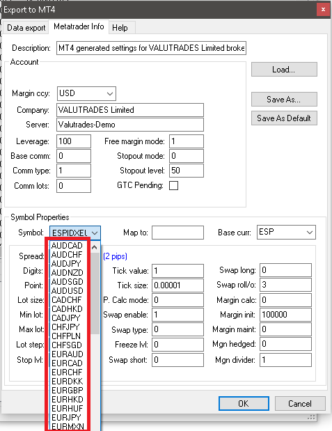

I deployed the TickstoryInfoExpert EA into the MT4. But after I load the setting files in tickstory, it doesn't seems to display the "SPACE+" subffix symbols?
I know the settings is not loaded correctly because the commission is not being included, as you can see on the above picture.
Re: Tickstory suffix problem
Hi Sunny,
You will need to use the "Map to" feature to map from "EURUSD" (for example) to "EURUSD +" on your MT4 terminal. This process is described in the manual and also if you search for "Maps to" in the forum.
