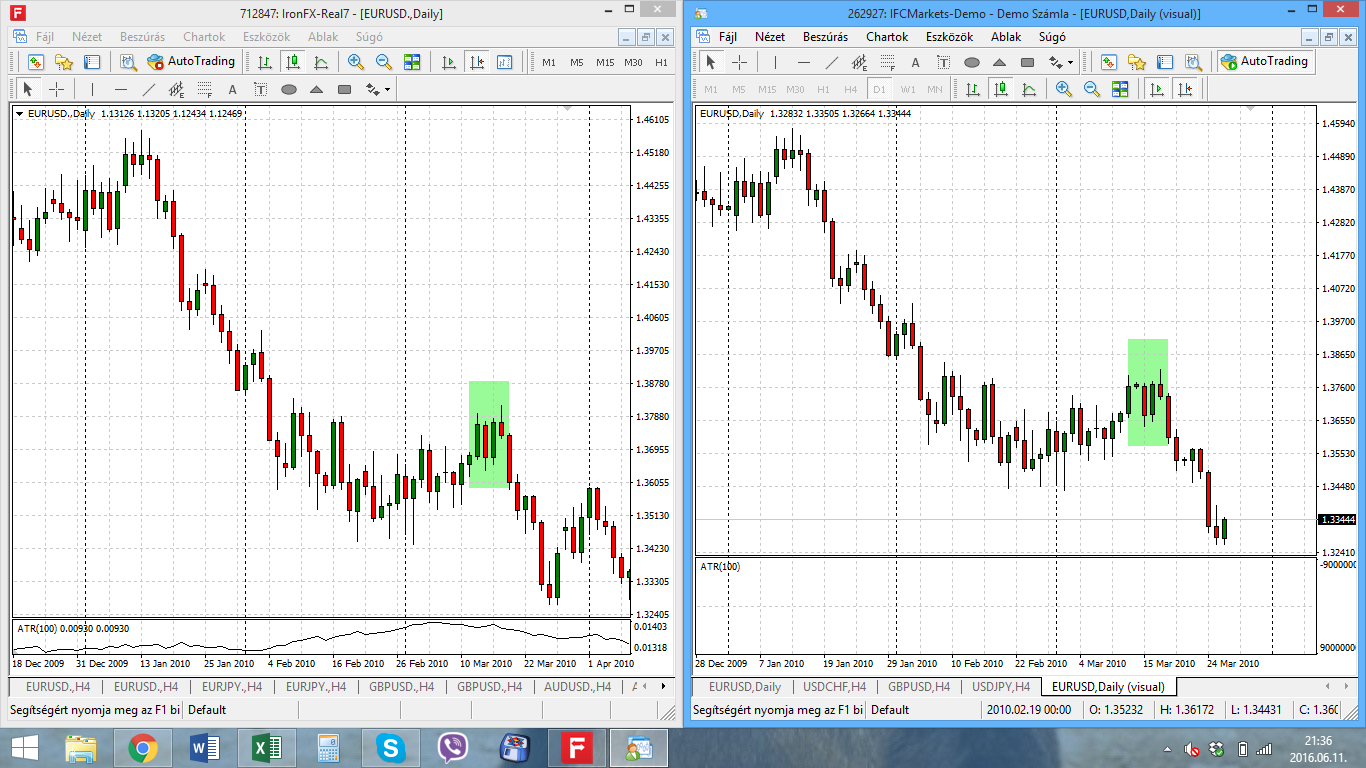

I have been trying, but still did not managed to download the data of EURUSD in D1 in the desired timezone. (GMT+2) I have tried everything and downloaded more than 50 GB data with different settings, with 1.8, the latest version of Tickystory in the MetaQuoetes 970 build. It did not react to any time zone settings, it generated data with the basic setting.
I'd like to get some help with the following: which settings do i need, to have data only from monday to friday, and do not include sunday 22:00 to 00:00.
In my opinion, i could do that with the help of the GMT+2 Eastern European timezone data. (I am from Hungary and would need GMT+2)
But the two does not look like the same.
I have tried to download data including weekends and without but still nothing had changed.
I have attached the images, you could see the difference between them. The difference is caused becuase of the sunday 22:00 to 00:00 data are included. I wish to see data only from monday from 00:00 to friday market closing.

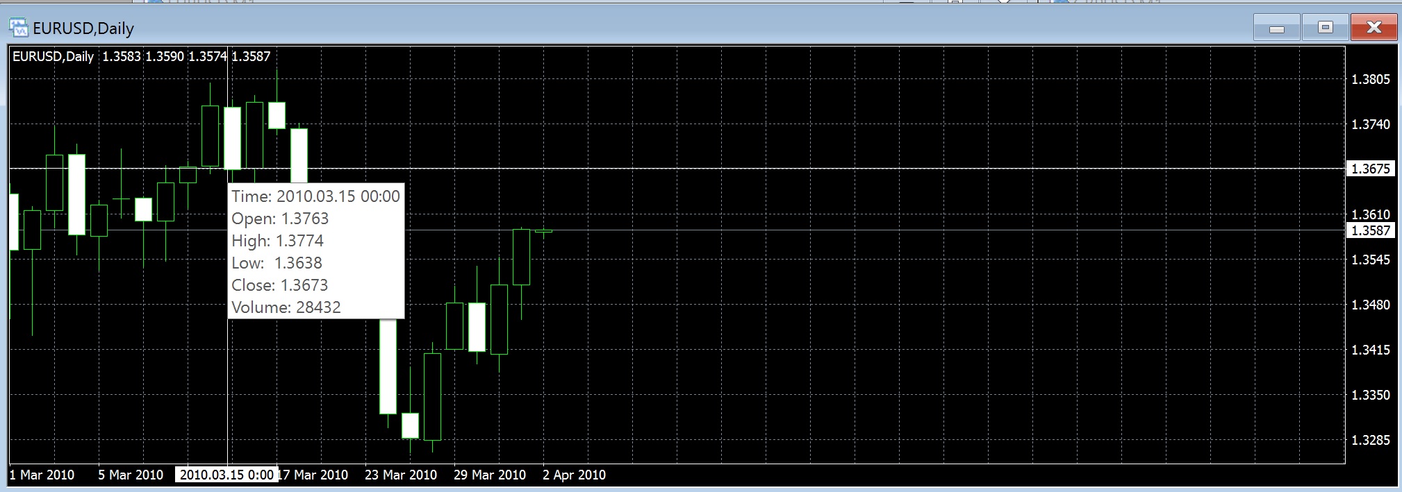

Looking at your screenshots, is Tickstory's chart the one on the left or right? Producing our own chart for EURUSD March 2010 (European DST timezone at the top of the list), it looks like the left-hand side chart. On the weekend of the 13th March, the last bar is Friday the 12th and the next daily bar is the Monday 15th March. Perhaps if you baseline in GMT for starters, this would make for an easier comparison?

thanks for the answer. the tickstory's version was on the right side. I wish to aim what is on the left side. The image you sent me, with the help of which settings can I approach the same outcome?

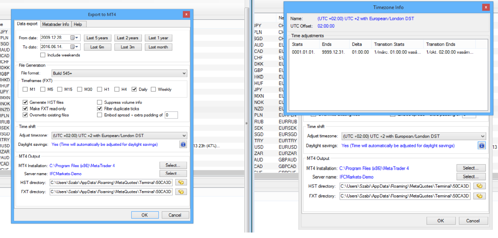

The settings were the default except for the start/end dates (1/3/2010 - 1/4/2010) and the timezone which was "UTC +2 with European/London DST" (toward the top of the selection box).
If you are still having difficulties, please click the "i" box to the right of the timezone selection and just double-check there is an entry for a 1-hour DST adjustment between 1st Mar - 1st Oct.

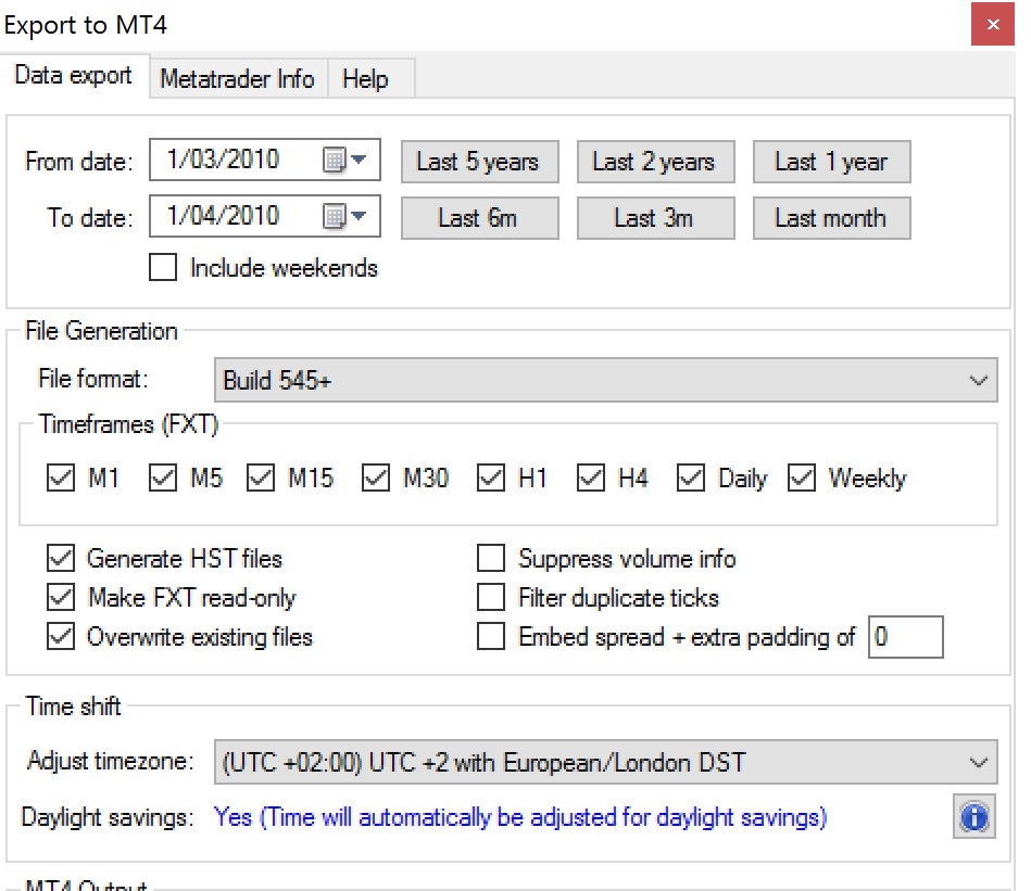

Thank you for your answer. I'm still having difficulties, I attach the image of my settings, please let me know if you did the same or if not, what should I change.
Regards,
Szabolcs
Re: Timezone Questions
Hi Szabolcs,
Please start by using the settings shown and then work your way from there. This should yield the chart we showed in the previous message. If you don't get this, then something else is a problem. In particular, make sure:
