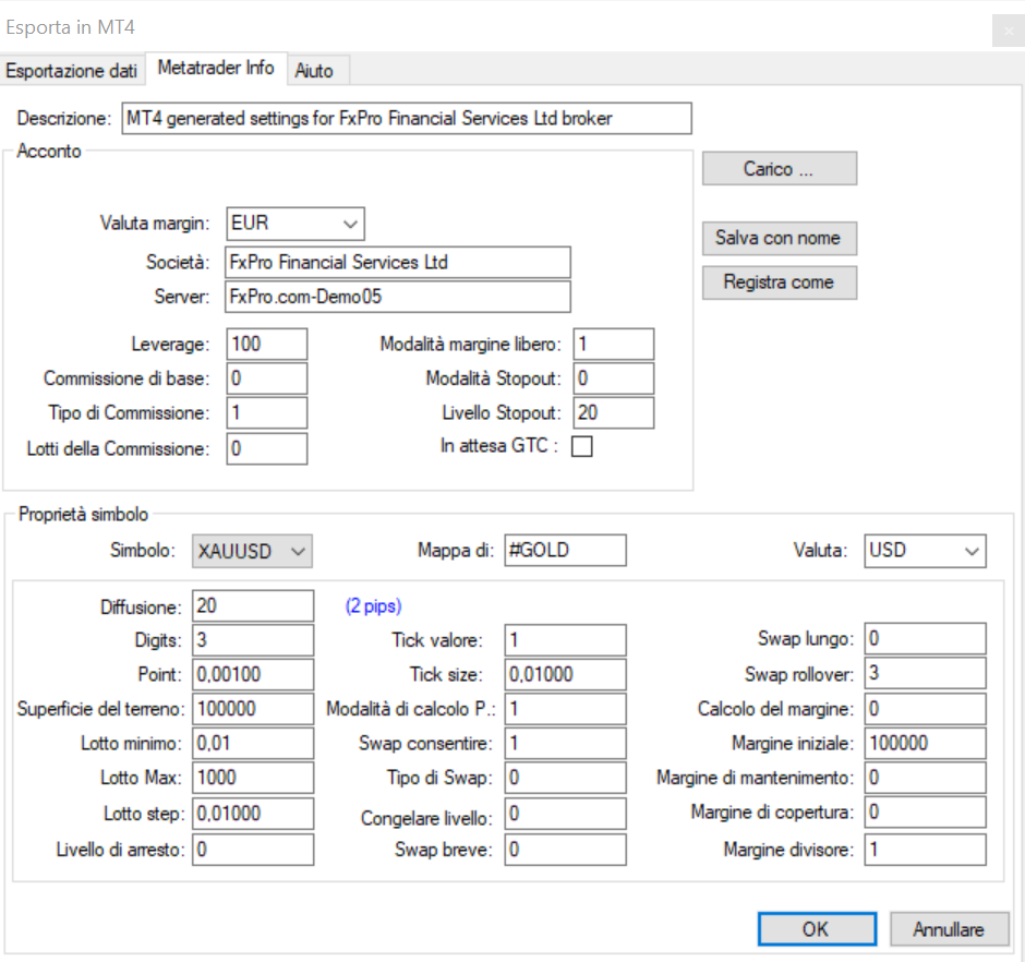

I downloaded tick data for GOLD (attached parameters)
But in backtesting i see that 0.01 lot are too big ...
Is there any problem about lot size ?
Thanks and regards!

Re: GOLD
Hi Apollocreed,
For GOLD, kindly use the method described here to get your broker settings:
https://tickstory.com/forum/viewtopic.php?f=2&t=809
The reason for this is that TickstoryExpertEA (or more specifically, MQL) cannot acquire certain information for "special" (non-Forex) symbols. In this case, the above-described method will get all the correct information. This will ensure you have the correct Lot Size parameter as per your broker.

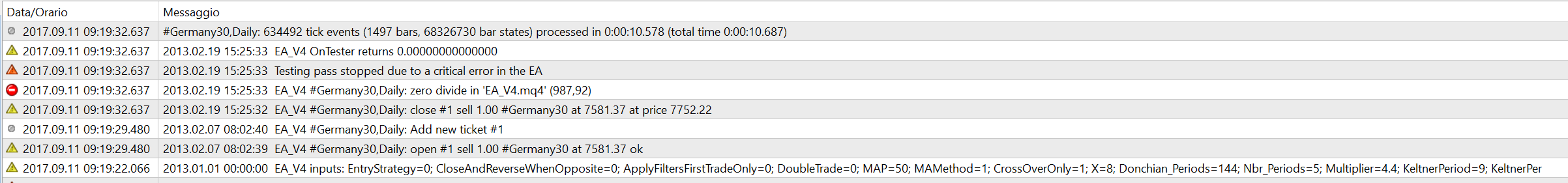

I have tried with the method described ....
But when I use DAX30 .... I got an error : "zero divide"..... ?
I tried with several EA , i got always same error
Re: GOLD
Hi Apollocreed,
The zero divide error is being generated by your EA. As per the logs, check line 987 of your EA code to see what value/variable is zero and work from there. If you have exported the correct settings as described above, then you should correct the error as it could theoretically the zero value could occur in a live environment.
