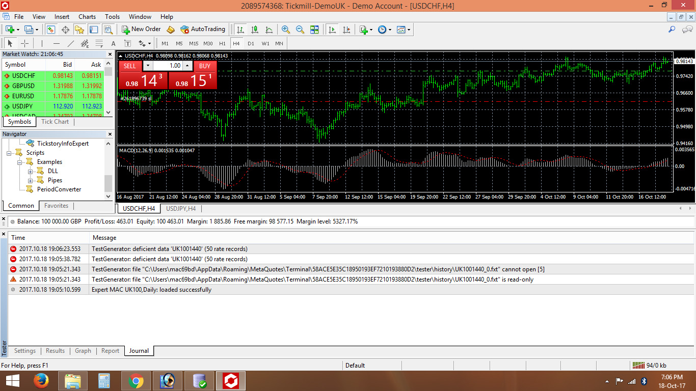

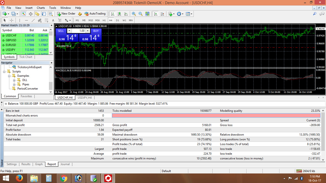

Re: Can not match symbol with broker symbol for download
Hello
Thanks for the reply. Actually, I don't understand whats happening.
1. I download data for gbpusd from Jan to Feb 2008, but when I backtest from 2008 to 2012 with the data I download from tickstory its test whole 2008 to 2012. But I download only two months of gbpusd data where all data came from.
2. For uk100 I try everthing but failed. now its saying "deficient data"
3.Download speed of data from tickstory is too slow. like for gbpusd if i select data for one year its took almost 3 hours to download. Is that normal? or any other way to download faster.
Attach picture
Attach picture

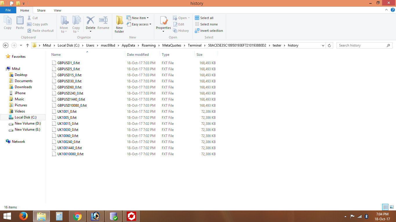

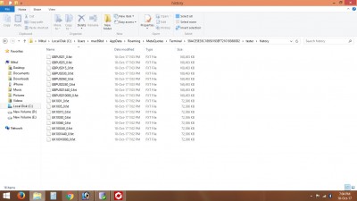

Hi Mac69bd,
Thanks for the screenshots, they do help. It looks like you are getting the "cannot open [5]" error message when trying to test with UK100. The most likely scenario is that you haven't exported enough data (as explained more in this thread: https://tickstory.com/forum/viewtopic.p ... =980#p4766).
You can prove the point by simply trying to back-test in say M1 timeframe. If the back-test proceeds, it means that you need to export more data. MT4 requires you to export at least 100 bars of data for any given time-frame. So for M1 time-frame, the minimum is 100 minutes. For the daily time-frame it is 100 days. Please correct this by exporting say at least 4 months and trying to back-test again.
Regarding the speed, the second time you export the same date range it should be a bit faster since Tickstory caches all the data it downloads from the web. You could speed things up a bit more by only exporting the FXT time-frames that you are using (only Daily/D1, for example). Just remember that if you do this and attempt to back-test in a time-frame that you haven't exported, you wont get 99.9% modelling quality.
It seems we're going through lots of different issues at the moment. Before attempting to back-test too many pairs (and scenarios) at the same time, can I suggest that we get things right for UK100, Daily timeframe and "MACD Sample EA" first. After this, you will hopefully be familiar enough to repeat the same process for any other instrument, EA and time-frame.
So in summary:
1) Export at least 4 months of GBRIDXGBP data from Tickstory, ensuring that you have the correct MT4 Settings and have mapped to UK100.
2) In the Daily timeframe, test the "MACD Sample" EA and make sure you get 99.9% modelling quality.
Please let us know how you go.
So in summary:
