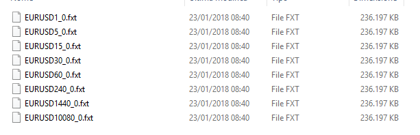

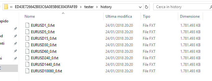

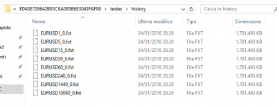

I bought the Tickstory license, after perfectly following the procedure (download the data EURUSD from 27/12/2016 to 04/04/2017), I checked the weight of the memory Tester -> History 1.8 gb (FXT).
I backtest for 3 months (01/01 / 2017-31 / 03/2017) the 99.90% model but it always stops the date of 14/02/2017. I tried to change several times but it always stops on 14/02/2017, why?

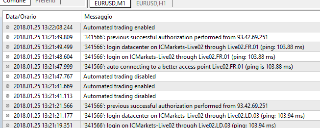

Thanks for the answer, it seems that the problem is solved by trying to download the data in different ways and now works with backtest for a year with model 99.9% (but stramente I memora 13 GB .FXT and works well). Now I would like to know how EA Tickstoryinfo works, I downloaded EA without modifying anything and I did AutoTrading (the smiley face), but I do not understand if it is processing. Then I tried to load the path on MetaTrader info but I can not find mt4config, can you help me?

I followed the path but the mt4config file is not there. The diary does not indicate any errors.

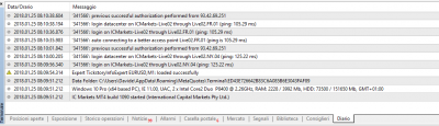

I deactivated autotrading and I activated a few seconds after the ticks moved but nothing changed, I activated backtest but still can not find mt4config
Re: Backtest always stops on a certain date.

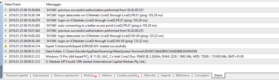

I tried a tick "allow DDL" it seems and the diary dices that serve a permission but not so what

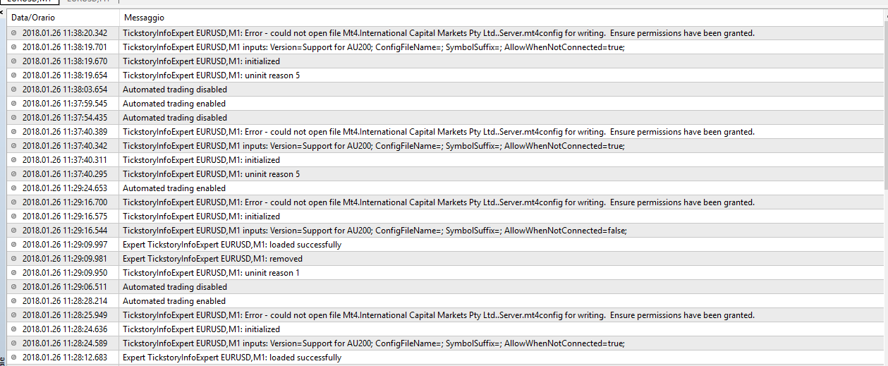

Hi Daio,
Looks like the EA is running now which is good, however it is giving an error that should be able to be resolved by changing the "Config filename" as described here:
https://tickstory.com/help/tickstorylit ... infoexpert
Once you do this, the m4config file should be created.

After several attempts I discovered that it was sufficient to remove the POINT!
initially I had configured:
- International Capital Markets Pty Ltd.Server..mt4config
as written by the advisor but then I modified it by leaving "Version" empty and removing a dot after the word "server":
- International Capital Markets Pty Ltd.Server.mt4config.
Can you confirm if I have configured well and with the screenshot?
