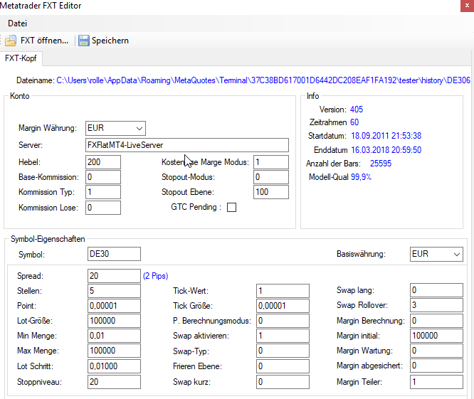

Dear together,
i always get the message in the subject ive i try to backtest my ea`s in the index dax.
The settings looks like this:

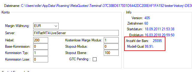

The datas by himself looks like this:
I was using the option "map to" so i think i was doing everything fine but were is the problem now?

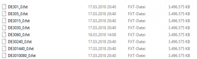

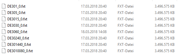

Are you sure you didn't miss a character somewhere when mapping? A sure way to tell is if another FXT file is being created when you back-test (eg. "DAX3060_1.fxt"). Some things to check (in order):
1) Have you exported at least 30 bars of data? (It looks like you have, based on the size of your FXT)

1 and 2 ) As you was saying already, yes i think i have more than 30 bars :)
In the picture you can see that the quality is 99,9%
That error is not depend on the EA because the EA is working on Forex for example, as well and if i use an other EA, i have the same problematik
