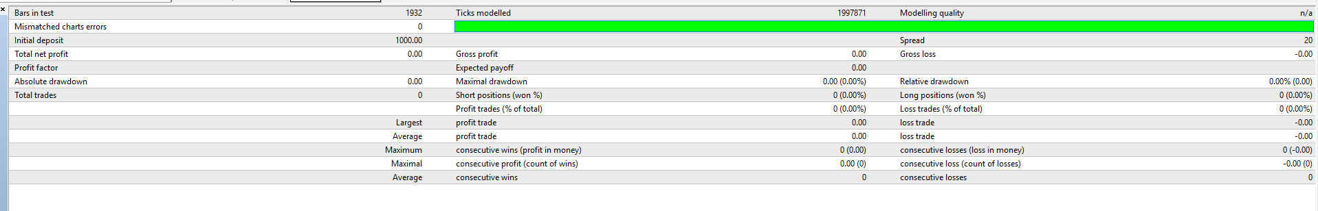

I have bought tickstory standard version.
After downloading the data into my metratrader platform (Build 1090) I have launched the backtest.
My issue is on the backtest result the modeling quality is not displayed as you can see from the screenshot. How come ?
Could you please help me to fix that issue ?
Regards,
Dorian

Hi Dorian,
It's likely that you haven't pressed the "Launch" button within Tickstory to start your Metatrader version. To do this, please press F8 or the Launch button.
For further trouble-shooting information on this issue, please see our FAQ here:
https://tickstory.com/help/tickstorylit ... ng_quality
