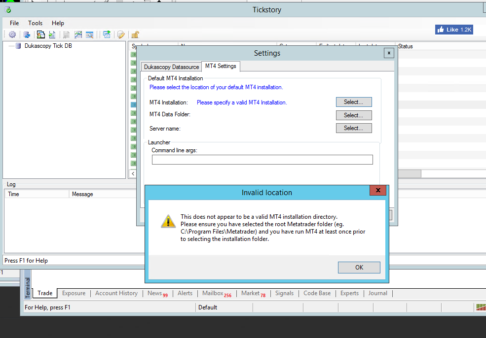

I just purchased full version. Followed guide and video. When I to to Settings on tickstory and choose the location for the data, I get an Invalid Location error message.
See screenshots.

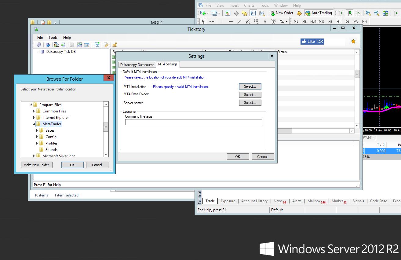

I deleted MT4 and redownloaded it, just to make sure I was trying to put tickstory data in correct MT4 terminal file.
What should I do? Screenshots of error message, and screenshot of where I'm trying to download the data to.
Invalid Location - settings for data location

Hi LorraineP,
Could you please confirm that you have started Metatrader and logged in before trying to configure it in Tickstory? Tickstory searches for some specific Metatrader files during the configuration that are only created after your first successful MT4 logon.

Hi LorraineP,
You'll need to log in at least once so MT4 can download various configuration files from your broker including the symbol list, etc. After this, you can configure Tickstory by pointing to the MT4 Installation folder and it should recognize the folder correctly since it will be able to locate the necessary files. Once configured, you can keep your terminal logged out and use the terminal for your back-testing.
