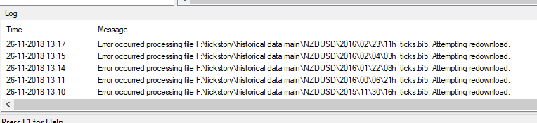

Hi there, it says "Attempting redownload"
When it shows this log, does it actually redownload and does not leave a gap in the data?
