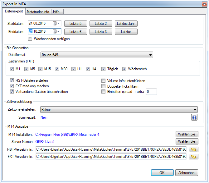

These are my export settings for EURUSD:
If anyone can help me, it would be much appreciated.
