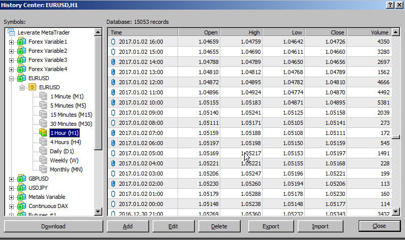

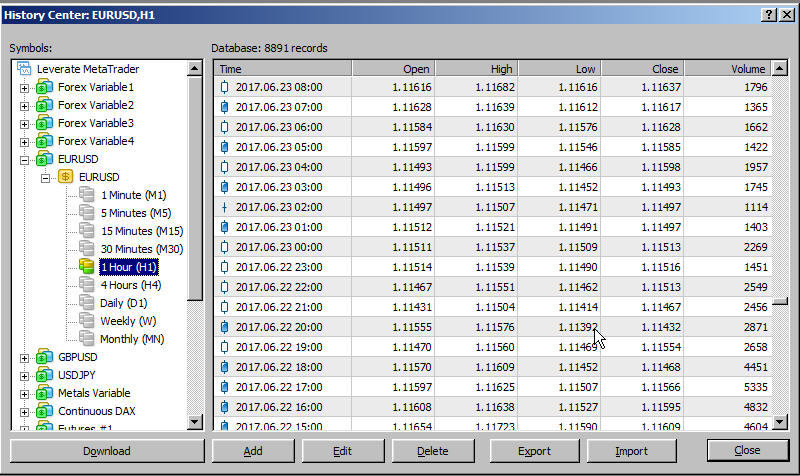

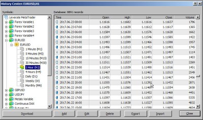

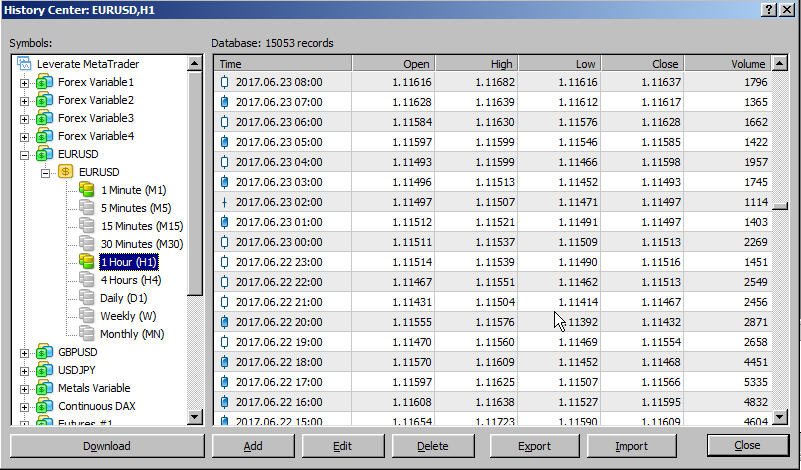

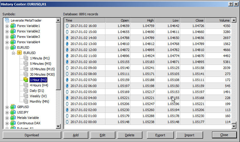

I re-do the backtesting on server1 again. The modelling quality is still 90%. I compare the datas from MT4_1 and MT4_2. They are identical (see screenshots). What could be the reason?

Thanks for the screenshots. Now that you've established the price data-sets are the same, the only variations can be:
1) Something is different in your "MT4 Export settings" (such as lot size, etc). You can make sure this is not the case by loading the FXT files in the FXT Editor and ensuring all settings are the same). If you have exported with default settings, they are likely to be the same.
2) Something is different in your Strategy Tester setup such as spread, initial capital, EA parameters, etc, causing different trading conditions and/or;
3) There is something in your EA that is causing it to trade on a different price, time or condition. This is something we unfortunately can't help you trouble-shoot, so you will need to look further into why your EA is trading at different times. As previously mentioned, this could be due to many factors such as an differing MA at the beginning of the trade sequence. This can obviously have differing affects on your results depending on how your EA is designed.
