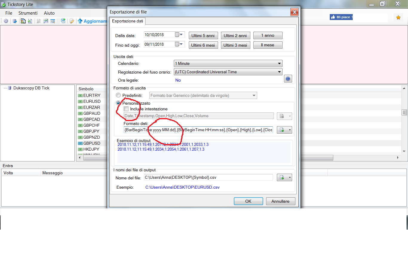

I have a big problem with importing data to Strategy Quant.
I can import tick data with the CSV2FXT format.
But 1 minute data I just can not. I also saw the video https://www.youtube.com/watch?time_cont ... lGoGvshKZw but nothing.
Can someone help me ?
Domenico

I solved by removing the check to "include header" and putting the point to the date format ( As shown in the image ).
