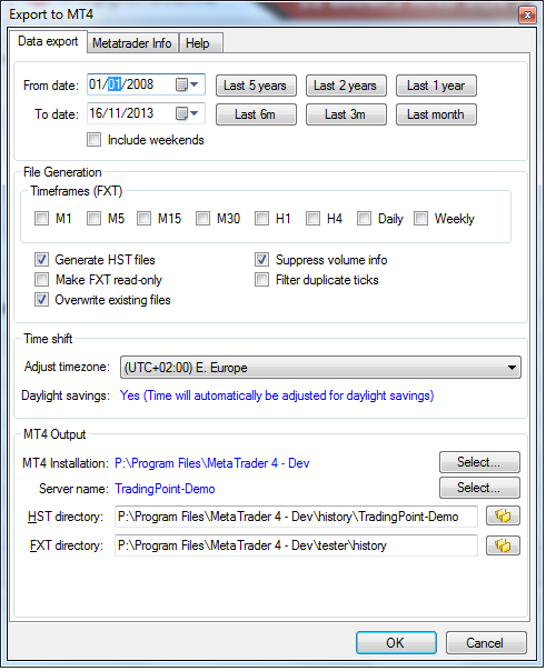

Hi Support,
I just need .hst files, and so deselected al FXT tickboxes on the "export to MT4" dialog. This caused .hst files containing garbage (O=H=L=C=1.0) for all time frames.
Selecting just the M1 fxt tickbox sorted the issue.

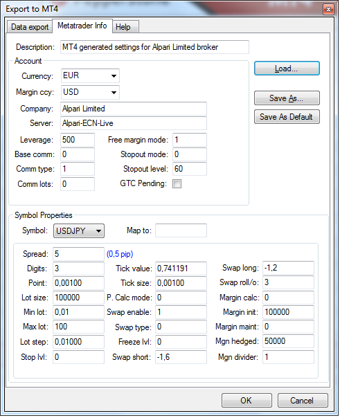

Regarding the dialog box saving settings, yes, this is an item that should be available next version. Do note though that you are able to export all 17 pairs in one go. Just highlight them and click on 'Export to MT4' and off you go. The settings for each individual pair can also be custom-set in the 'Metatrader Info' tab if you desire.

I had the same problem today with Tickstory lite version 1.1.0.0.
I tried to export data to MT4 history.
Because I don't need FXT files, I deselected them all.
Moreover I did some other export configuration changes, like timezone.
Then i loaded the .mt4config to match my Alpary broker config

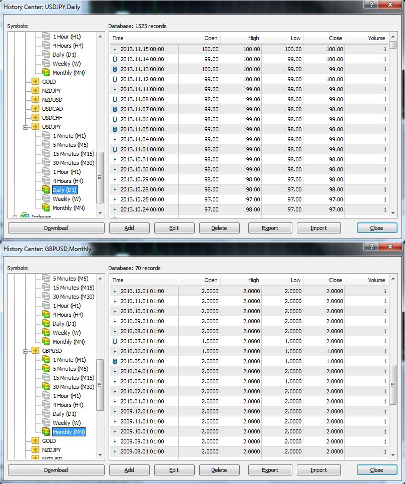

The result was really a mess! :cry:
For JPY based currencies most data values are the same because they do not contain decimal values.... :?
About GBPUSD, Tickstory exported all values to 1.0000 or 2.0000 for every Timeframe... :o
About EURUSD, happened something even more strange: all timeframes are fine except M5 and M15 having 1.0000 data everywhere....

Re: TickStory generates bad data when all fxt deselected
Hi Jdaniele,
Thanks for logging a problem report. We've reproduced the issue and it appears related to the fact you are not exporting at least one FXT time-frame. The workaround for the moment is to ensure at least 1 FXT time-frame is selected. We will work on addressing the issue in the next version.
