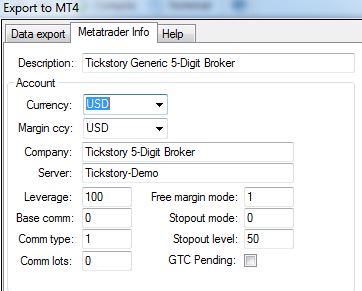

I am using MT4 build 439, Tickstory V.9b, and I used the Tickstory Generic 5-Digit Broker in generating fxt and hst files. What should I do to have the sl and tp prices correctly set up to three digits?
Attached are the screenshots for reference.
I also have a question about the Base Comm, Comm Type, and Comm Lot in the Metatrader Info section. What should I input on these fields if my broker charges a fixed 25 USD per round-turn lot?

With regard to commissions, Tickstory allows you to specify the "raw" values that are embedded into the Metatrader FXT which are as follows:
Comm type: The base commission type - either Money (set to 0), pips (1) or percent (2).
Base comm: The commission value - this is the amount of Money (if Comm type is 0) or Pips (if Comm type is 1).
Comm lots: The commission charge type - can be Commission per Lot (0) or Commission per deal (1).
So to specify a $25 lot, you would need to set the values:
Comm type = 0
Base comm = 25
Comm lots = 0
