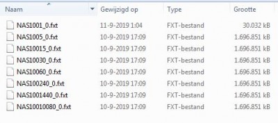

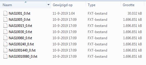

Thank you for your fast response! This solved one problem but I think this is a Tickstory bug, isn't it? I had to install MT4 Terminal.exe Build 1170 to launch eventually MT4 from Tickstory Lite. I exported the FXT files read-only but then MT4 complains about that when a backtest is started. I had to write enable them and then MT4 overwrite the FXT file of the timeframe of the test just as it does when it was started outside Tickstory! So, I don't see the advantage of starting MT4 from within Tickstory because this should be solving that problem but it doesn't.

Hi Watchme,
MT4 does not "complain" when the files are read-only - this is a notification message only. Please continue as normal.
