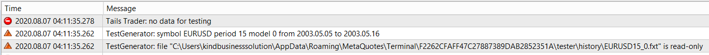

Just downloaded latest version of Tickstory (standard), and tested the MT4 strategy tester (launched from TickStory). Keep getting a "no data for testing error" which I cannot resolve. Prior to my update today to the latest Tickstory version, I definitely downloaded this currency pair my date range.
Do I need to re-download the tick data for the currency pair? Also, the odd thing is that even though my strategy tester is set for a 2019 to 2020 range, the journal shows 2003???
Please advise....
Settings:
2019-2020
2019-2020
Journal:
2003?
2003?
Report:
99.9 modeling quality

Hi JJmayer,
It looks like there is data available but your test dates are incorrect somehow. I would try unchecking the "Use dates" box and see if that helps. You may also want to use a standard EA such as "MACD Sample" to rule-out any EA-specific issue.
You can also double-check the actual data you have inside of MT4's History Center.
P.S. No changes were made in Tickstory between the last two versions that would have any affect on your exported data.
