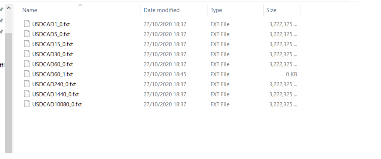

I have redownloaded data several times for different time periods and it either skips big chunks of data or gives no data error. Also after i run the test and go to check the data files in the tester i get the new file appear there that shows 0kbs or other low amount. Image attached.

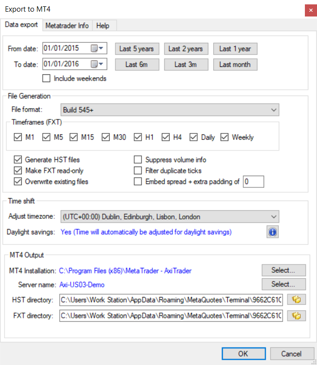

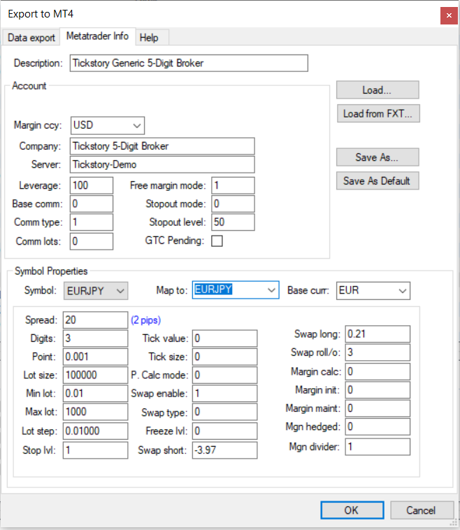

1) The Tickstory "Export to MT4" settings you are using (including the "MT4 Settings" tab) Image attached.

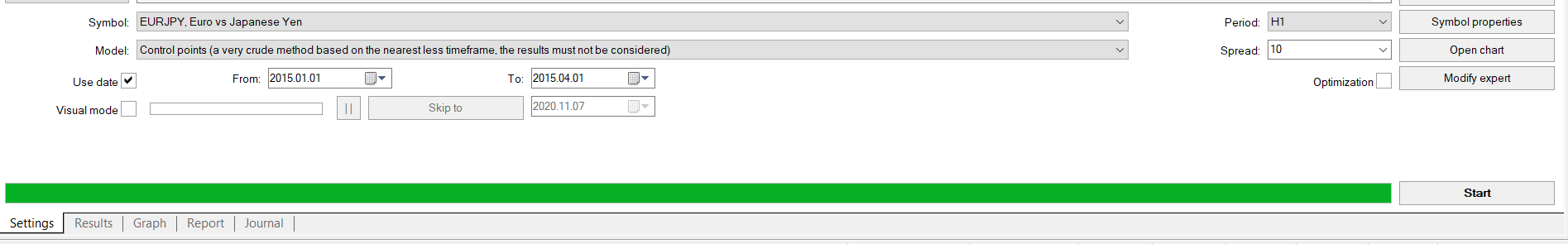

2) The MT4 Strategy Tester window (which shows the symbol name) Image attached.

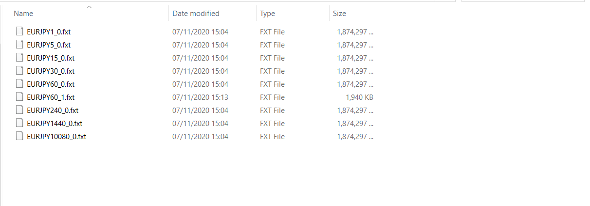

3) Your "MT4 Data Folder" FXT contents (go to File->Open data folder in Metatrader and then browse to tester/history and take a screenshot). Image Attached.

All the screenshots i have supplied represent the actual data that i downloaded and the settings selected. The current downloaded data is for 01.01.2015 to 01.01.2016.
The test was run on the 3 months test 2015.01.01 to 2015.04.01.
The downloaded data EURJPY, mapped to EURJPY the same as on the tester symbol.
