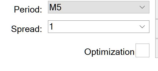

Hello, in metatrader 4 strategy tester journal tab, I can see that variable spread is enabled but when I change the spread value manually like in the attachment, the outcome changes a lot. Normally when variable spread is enabled, changing spread manually shouldnt effect anything if Im not mistaken.
EDIT: Tried opening as administrator but still the same.
EDIT 2: Its fixed now, the cause was exporting tick data using Mq4 script. When I use "map to" its working fine.

Hi Gu00hero,
Please make sure that when you report any issues that you can replicate the issue using only our software. We unfortunately do not support any third party scripts and therefore cannot guarantee they will be compatible and/or have their own issues which we won't be able to assist you with.
