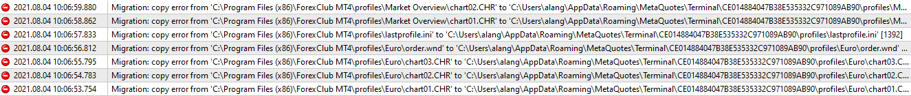

Also, when I go to the "Journal" tab, I see there are a lot of errors.

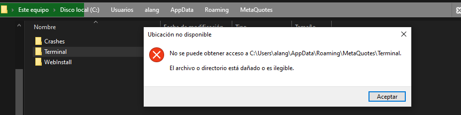

And finally, when I go to the folder it indicates, I get a warning message. I'm really confused and also desperate, I've already reinstalled it twice, but nothing seems to work... Does somebody have a clue of what could be going on? Or how can I fix that issue
File explorer error
File explorer error
Journal tab errors
Journal tab errors

Hi AlanGF7,
The error you are seeing is not related to Tickstory. It appears that the folder is not accessible due to Windows permissions. Until you resolve the error on the first screenshot, you will continue to have problems. You will need to administer your system so your Windows login has access to the folder & files.
