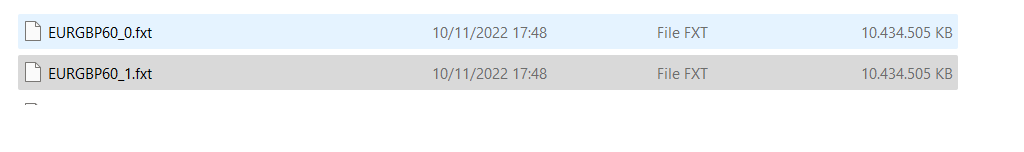

Everything work fine with TickByTick, but when I try to make a control point test, program creates a ne Fxt file (_1) with a day of data.
How can use the fxt file fro tickstory?
Can you explain me the steps?
UPDATE
I Copy and past the tickstory file (FXT...._0) and rename in FXT..._1 , and know works, but I dont think its the right way

This is what I've done. with TickByTick method everything works fine, but with ControlPoint, Mt4 doesnt use the FXT file bigger (the one created by Tickstory) , but creates a new one (named FXT..._01) with the few data of last one day.
I solved this copy and pasting the FXT file_0 and rename it in _1, the one used for the control point test,

Hi Lucky.Sim,
The behavior of creating a *_1.fxt file is expected. MT4 creates a "*_0.fxt" file for the tick-by-tick method, a "*_1.fxt" for the Control Point method and a "*_2.fxt" fxt file for the 'Open price' method. Each method requires a different file because it uses a different set of data. The tick-by-tick method requires a different set of data points than the Control point method. The former has all the ticks in it versus the latter which has only the Open, High, Low and Close points in it.
Basically, there is no need to do anything extra to use the tick-by-tick, Control Points or Open Price methods. Just export your data from Tickstory and select the method you need. That's it.
