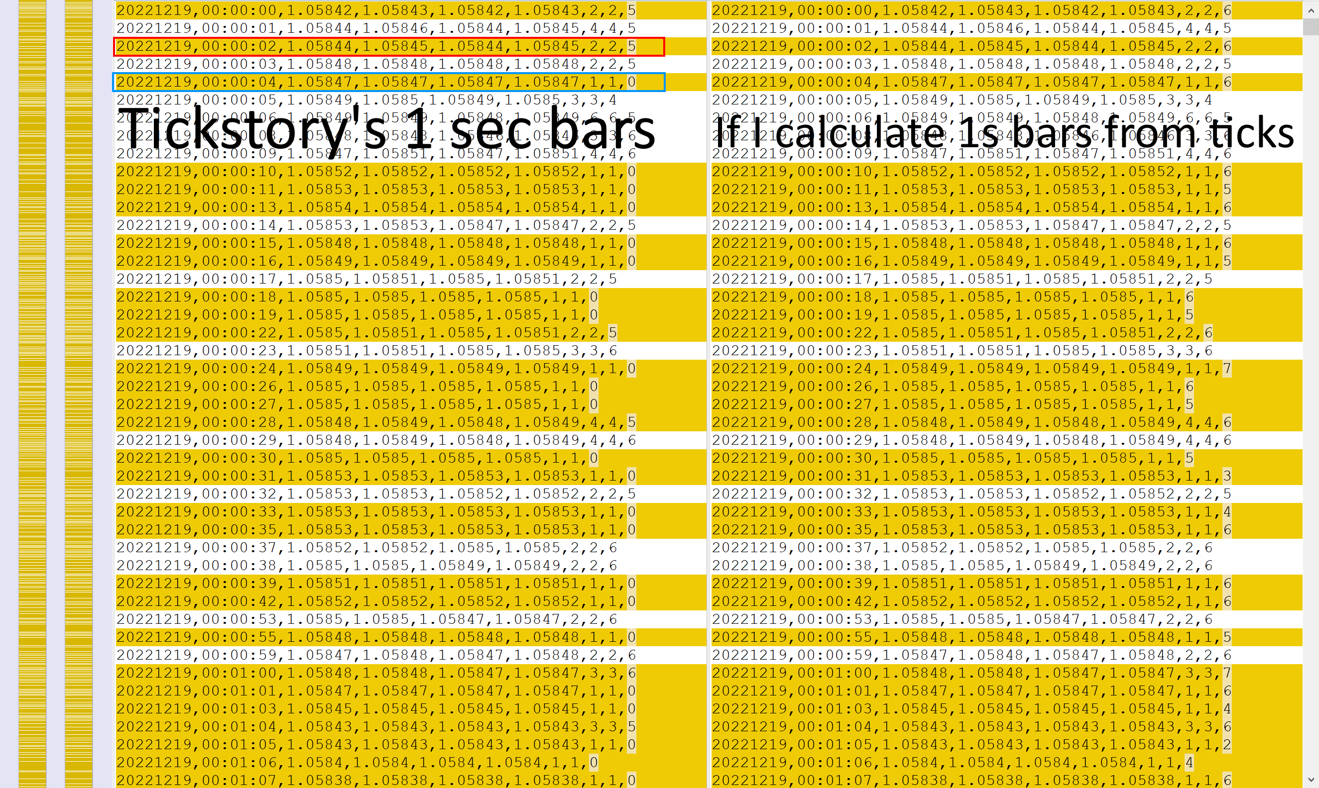

I noticed a difference in the value of BarMaxSpreadInt between how Tickstory calculates it, and how I thought it should be calculated:
I first exported all EURUSD ticks for a whole day (in this case Dec 19th, 2022) in MT5 format from Tickstory, then I exported 1 second bars from Tickstory for the same duration, then I looked at the resulting bars to try to understand how BarMaxSpreadInt is calculated.

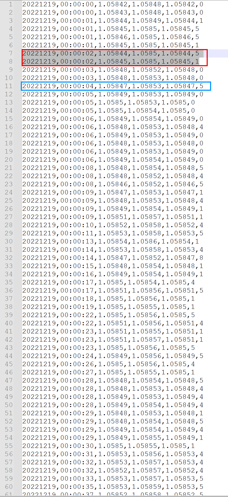

  • If a bar only contains 1 tick, the BarMaxSpreadInt of that bar should be the int spread of that tick, right? But that's not how Tickstory calculates it: All bars that contain only 1 tick have a BarMaxSpreadInt of 0 in Tickstory's output! See the blue rectangle here (https://i.imgur.com/g55pZwr.png)
    CSV Extract
    CSV Extract
    which is the only tick that happened during second 04 and the corresponding 1 second bar in Tickstory's output here on the left (https://i.imgur.com/cSSxbCF.png)
    Comparison
    Comparison
    which has a BarMaxSpreadInt 0. (You can verify this yourself, check any bar that contains only 1 tick, they all have BarMaxSpreadInt = 0.) Btw, that screenshot is from WinMerge, as you can see, all bar values between Tickstory's output and my own calculation are the same except BarMaxSpreadInt (the values I calculated from Tickstory's ticks are shown in the right column).

    That's apparently also not how Tickstory calculates it. Compare the red rectangle in the above two screenshots: The first image shows that there are 2 ticks within second 02, so the corresponding 1 second bar is made from 2 ticks. The int spread of the first tick is 105850-105844=6, and for the second tick it's 105850-105845=5. The max of 6 and 5 is 6. So I would think that the BarMaxSpreadInt of this bar should be 6, but Tickstory's 1 second bar output contains 5 as the value for BarMaxSpreadInt for this bar (see red rectangle in the other screenshot)!
(These are just two examples, you can see from the lines that WinMerge highlighted, that many bars have different BarMaxSpreadInt values between what Tickstory bar output says vs what I calculated from TIckstory's ticks.)
