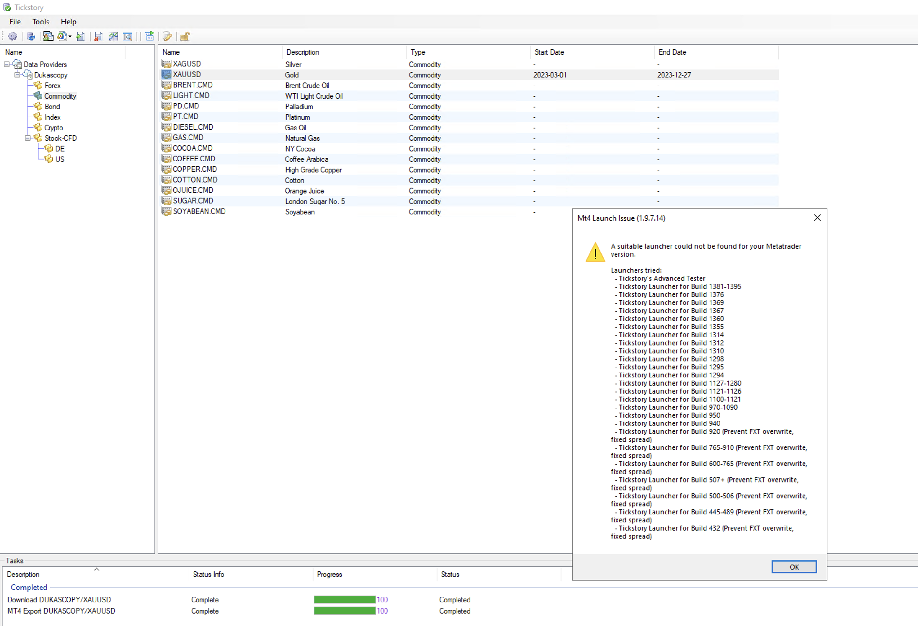

I've been using Tickstory for almost a year and suddenly started getting this error message yesterday. I have uninstalled and reinstalled and am using the latest version 9.7.14. I'm using Metatrader build 1380.

When you say MT4-related applications, are you referring to MT4 terminals or not? I have installed multiple terminals but no other MT4-related applications. It also appears as though it may not be using 1380 launcher.

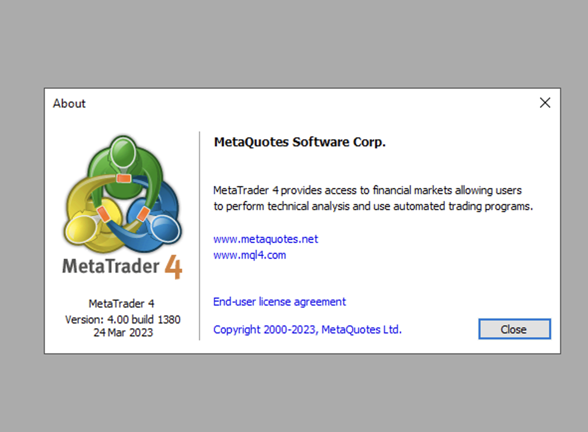

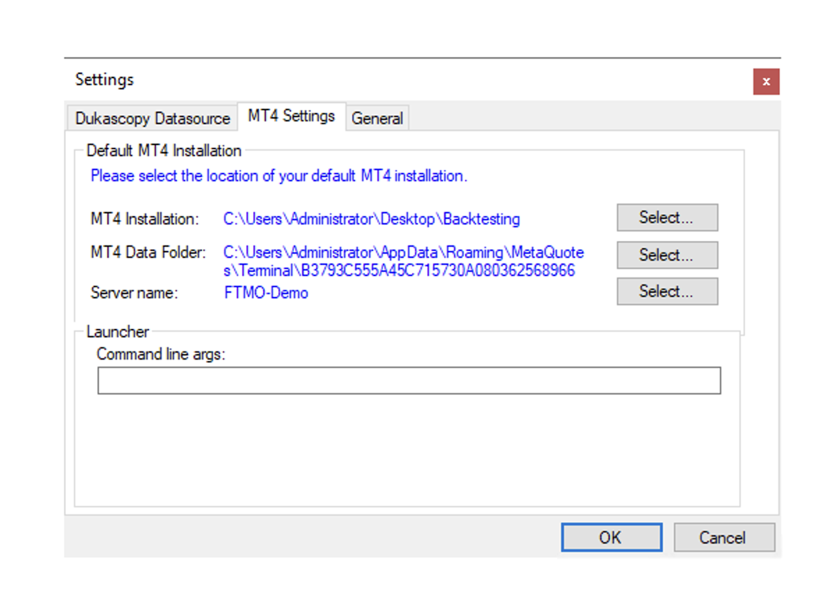

If this is not the case, could you please try start up MT4 manually and send us a screenshot of the About box and also your MT4 configuration in Tickstory.

Unfortunately it's not realistic for me to uninstall my other MT4 terminals as I actively trade on them everyday. I've used Tickstory for almost a year with other MT4 terminals installed on my VPS with no issues until now. I've attached screenshots of the about box and MT4 configuration.
