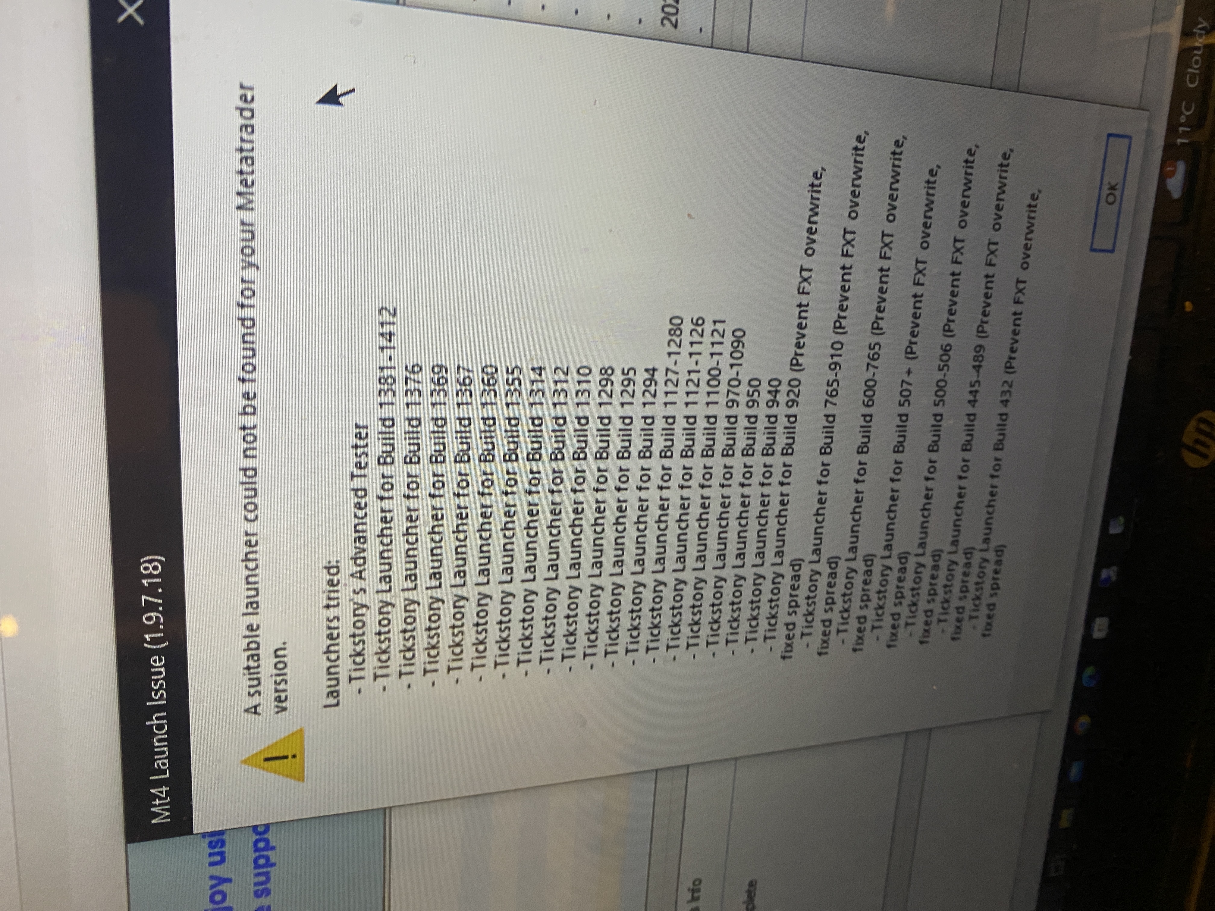

Mt4 launch issue (1.9.7.18)
Post by get_smoked »
Hello I was following all the steps from this video https://youtu.be/08PM5maS7KE?si=BqLRFAPfDfu4XAGl
Then on the last step where I launch the mt4 from tickstory I got this message below. How do I fix this please
The current build of the mt4 is 1420
Re: Mt4 launch issue (1.9.7.18)
Hi Get_smoked,
We have just updated Tickstory LIte to v1.9.7.19 which supports MT4 Builds 1418 until the current 1420. Could you please download this latest version and try again.
