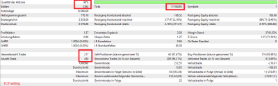

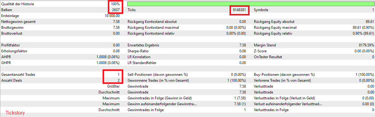

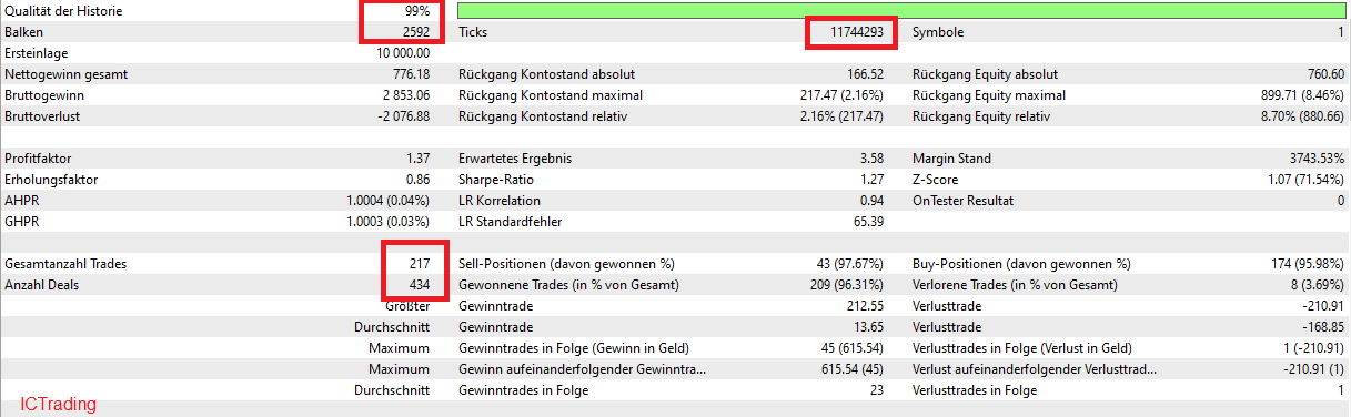

Hi again.
I tried MACD and it showed "some" trades, but big differences.
I used now my own ea and tested with ictrading data and tickstory. results are completly different!
Please see screenshots. How can these different results happen?
Re: MT5 Bars Import not working
Hi Charme77,
It is expected that you will get differences between two sets of data. How big a difference depends largely on how the EA is coded and the strategy itself. For example, if it is a scalping EA, then each trade is likely to see slight differences due to entry and exit prices. These differences will add up. For a longer-term trading strategy, it may be that your entry condition is triggered in one set of data but not another (for example, a moving average is not crossed at the same time in each set of data). This may cause knock-on effects where the strategy remains in a trade (or not), affecting the results. Of course, some strategies might have various delays or stops to trading as well.
Obviously we cannot comment on your specific strategy as you know it best. The goal here should be ensuring that your EA trades consistently on each set of data. If it is not, it's important to determine why otherwise it will also behave unexpectedly when you eventually trade it live (i.e. on an unseen/new set of data). The best way to understand the differences is by comparing the first trade and analyzing its entry condition and exit. Why are they different?
