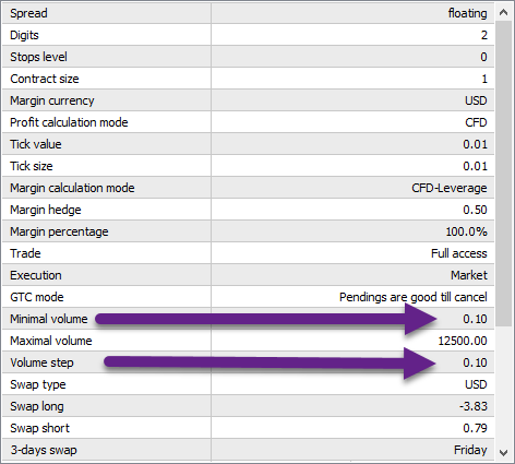

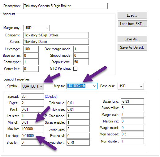

I get the Cannot open5 error when I change the values to match my broker specification. When I map it shows at the arrows on tickstory 0.01, however my broker specifications are 0.1.
If I leave it at the tickstory values 0.01 then the download works 100% fine and I do not get the file open error

Re: File cannot open[5]
Hi TrendCatcher,
Thank you for your clearly illustrated screenshots. Tickstory acquires this information directly from the Metatrader data however do note that these values are specified as "raw data values" which means they could be subject to change internally when MT4 does its calculations. In short, you should just use the values that Tickstory gives you when you select your "Map to" symbol unless there is some specific reason for you to change them.

Morning. Yes it is a problem, because when the backtester tests the results are wrong. Position sizing should be based on min position of 0.1 and not 0.01, the step should also be 0.1 and 0.01. So my $Profits are wrong on the backtester. This is very important for me to fix.
