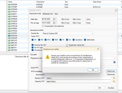

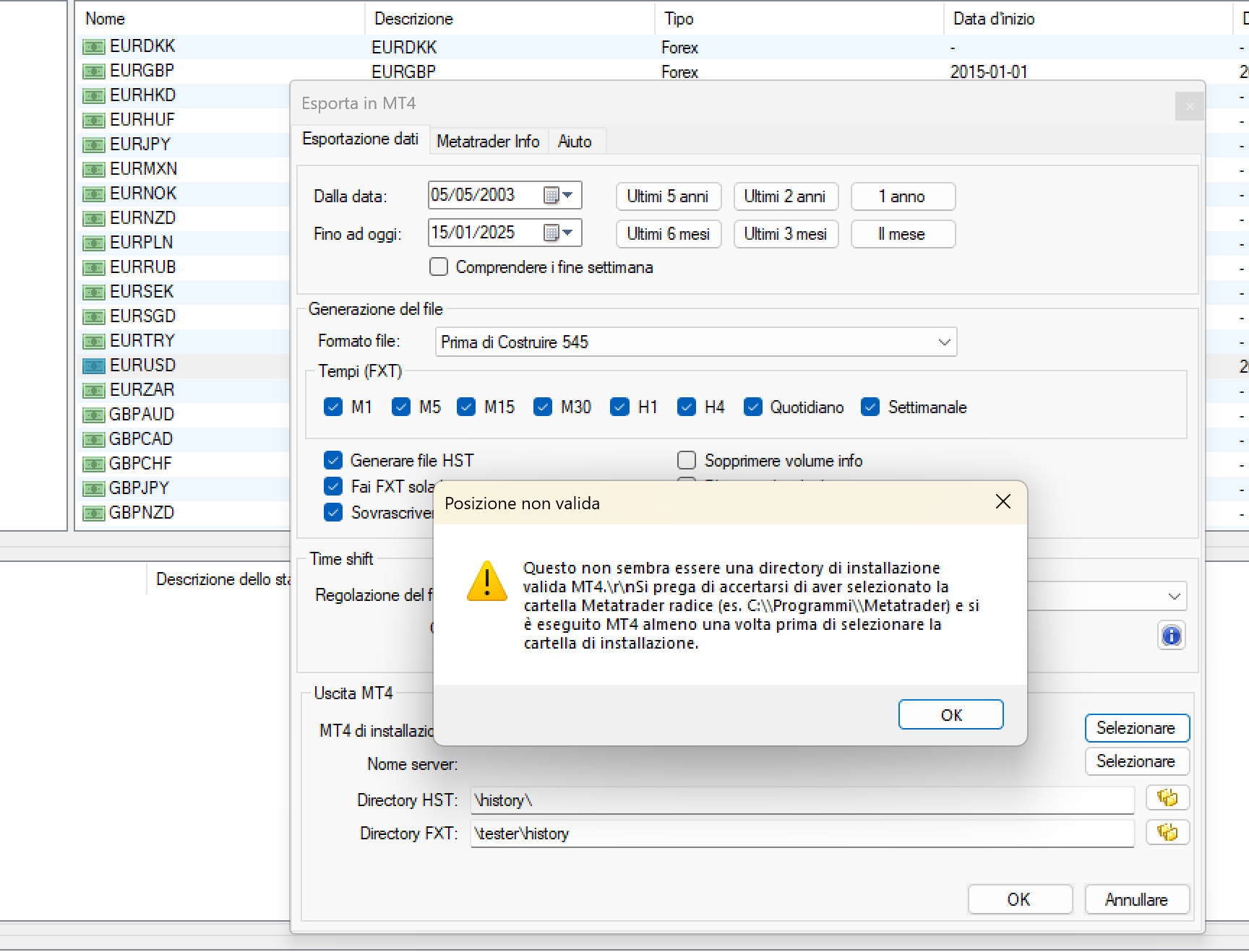

UPDATE
I've setted the mt4 as "portable" to set all on the external hd, but now i have another problem:
Ticjstory doesn't detect the mt4 as on the following screenshot:
How could i solve it? Thanks

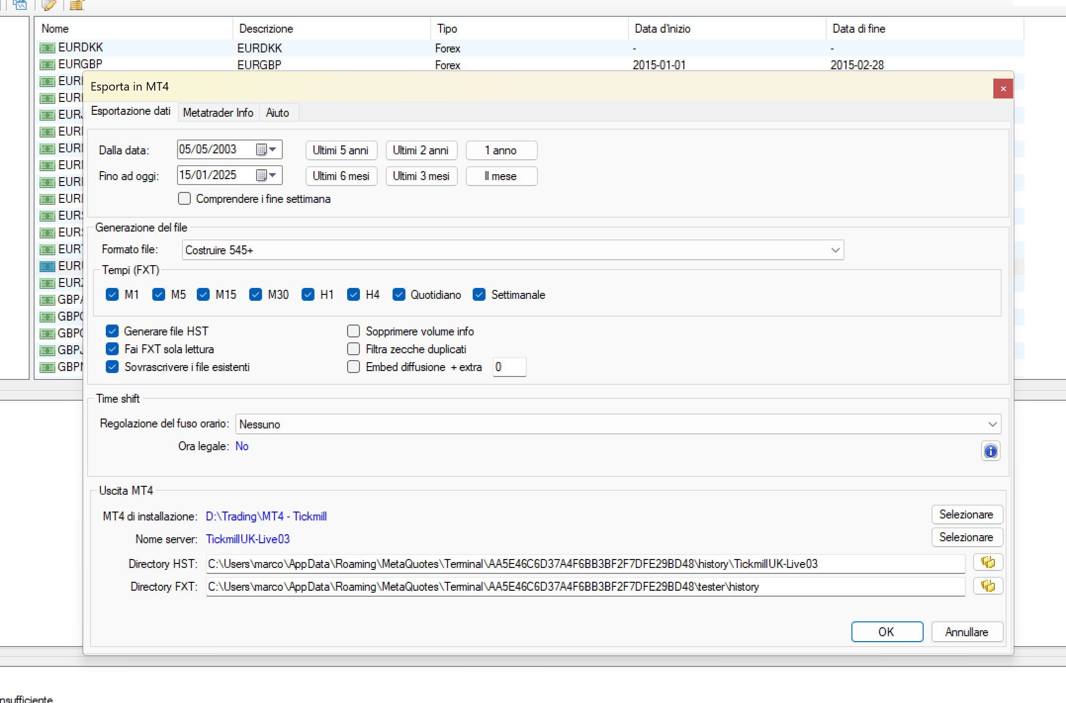

NEW UPDATE
I start the mt4 from the non portable terminal and now Tickstory read the platform but take as default the 2 folders on C: (screen n.1)
I think i need to change manually the 2 folders (screen n.2)
Correct??

Re: External HD for data
Hi MrBig,
It should not be necessary to manually change the folders in the "MT4 Export" window if you have correctly configured Tickstory. Please ensure that in Tickstory's File->Settings->MT4 Settings that your "Data Folder" is selected correctly. It is this setting that will be defaulted every time you export to MT4.

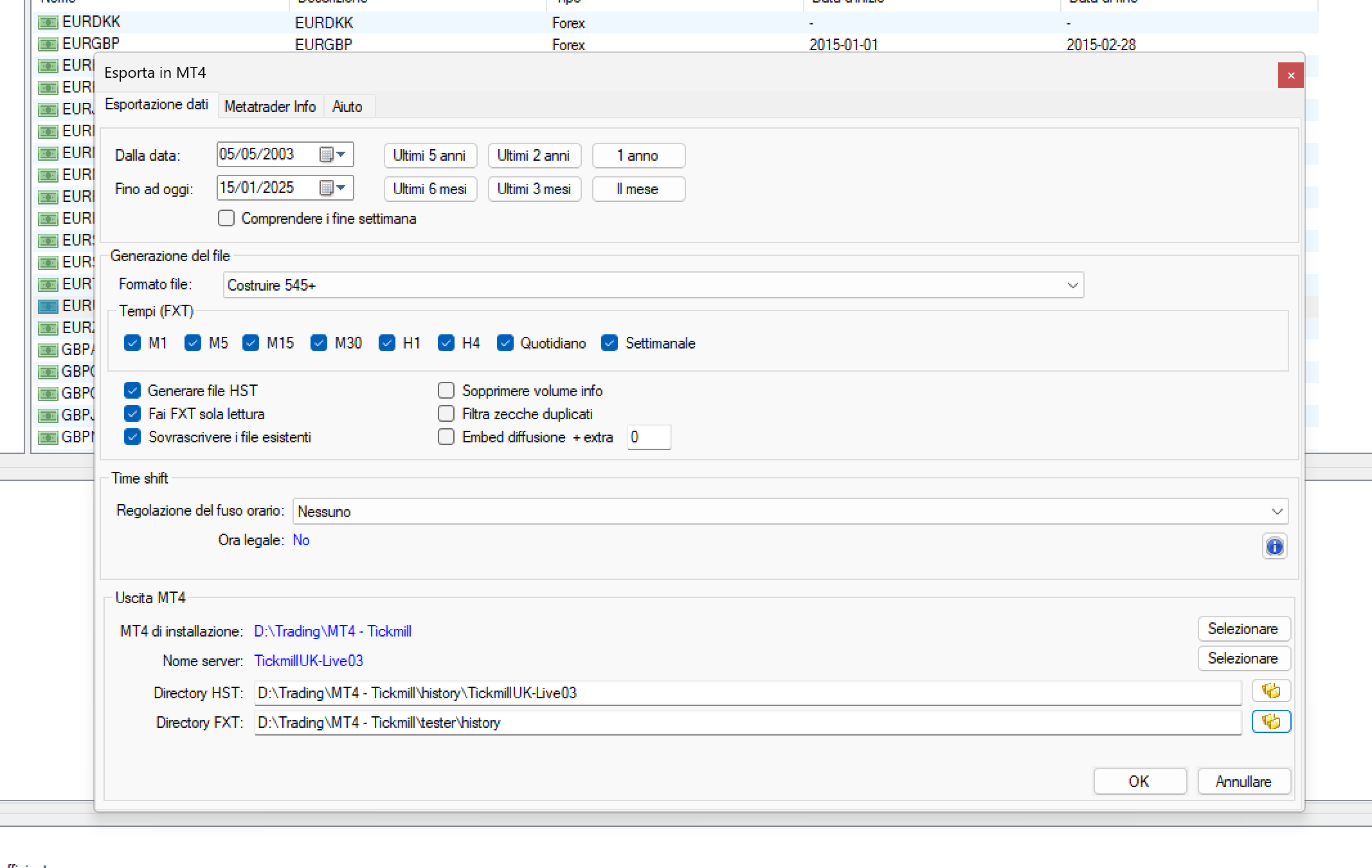

Please, give a check to the last 2 screenshot.
If i set the mt4 on D: (external drive) as default tickstory detect the 2 history folders on C: (laptop hard disk)
For this reason i think i need to change manually the 2 history folders as the folders on D: created with "portable mt4".
Am I right?
Hi MrBig,
As before, you should set up your configuration correctly. If you are intending to use a portable configuration, make sure you set this up as specified in our manual. There should be no need to alter the folder manually and this feature is intended for advanced use only.
