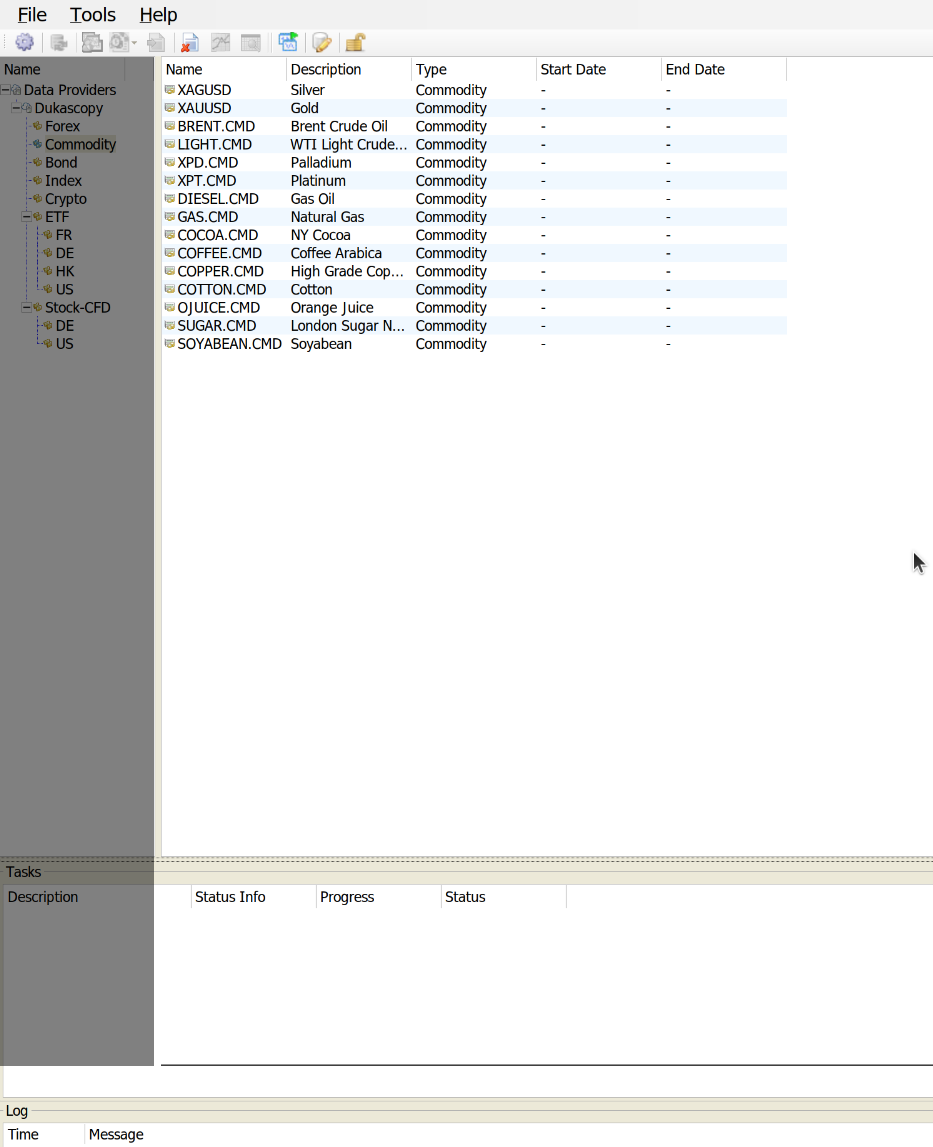

I am successful in running Tickstory Standard 1.9.8.12 on Ubuntu 25, using Bottles, which is an environment that allows me to run Tickstory on Wine using the engine soda-9.0-1.
Everything seems to be working more or less fine, the roadblock I currently have is with the Settings, once the dialogue window pops up I can see the tabs but the frames inside are just empty. Also, as you can see from the screenshot, in general the UI is a little wonky (but still usable):
I have tried to use dotnet35sp1 as suggested somewhere else, I have also tried other version of .NET, but in reality this works even with Mono, it won't make a difference with the UI.

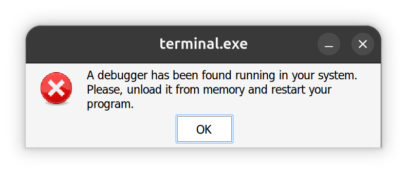

What makes a difference with the UI is actually changing the runner to sys-wine-11.0, which renders the UI in a significantly different way, but besides being way slower, it also then causes problems with launching MT4 with a message "A debugger has been found running in your system. Please, unload it from memory and restart your program.":
I haven't gotten to the point of testing the actual download or export, because first I want to setup the proper directories in the Settings to prevent further issues around. My next step would be to try and do the setup while under sys-wine, then closee, change it back to soda (which MT4 is happy with), and see if it works. But it sounds very cumbersome.
