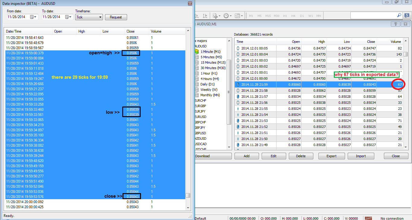

1. Number of ticks in Dukascopy data do not match to exported data. Please see attached below:
There are 29 ticks in selected minute, but in metatrader it show 67 ticks.

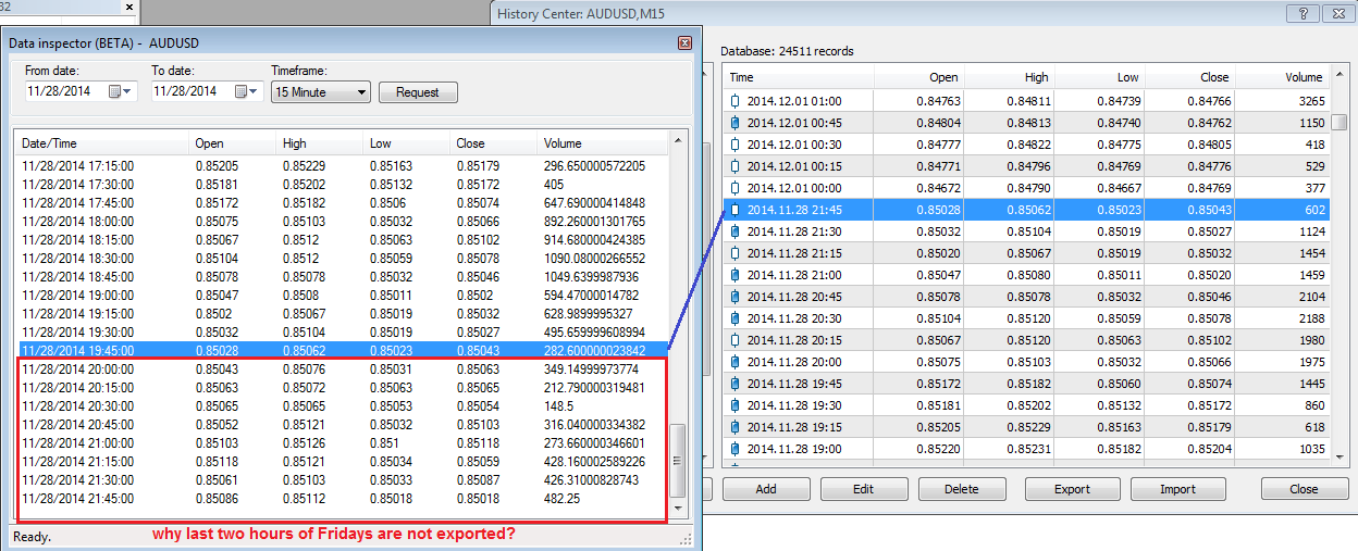

2. I searched on the forum for this one, but didn't get a clear answer. And the problem is why last 2 hours of Fridays are missed? Here I quote your own words:
tickstory wrote: The 'filter weekend' option will filter all tick data that occurs after Friday 22:00 hrs (UTC) and before Sunday 21:00hrs (UTC). It will then perform the time-shift to the selected time-zone and create bar data from this. This means that if the converted times fall between Monday 00:00-23:59hrs, then yes, everything will be seen on that bar.
Seems that "filter weekend" filters data after Friday 20:00? If not what could have caused the missing?

1. Tick volumes: why they don't match the number of ticks in source data?
2. Why last two hours of Fridays are missed?

1) When exporting 'volume', the current version of Tickstory will export the actual bid/ask volume information. By default, however, the 'Suppress volume' option is checked which means that all volume will read '1'. There is further discussion on the topic of volume here: http://tickstory.com/forum/viewtopic.php?f=2&t=222

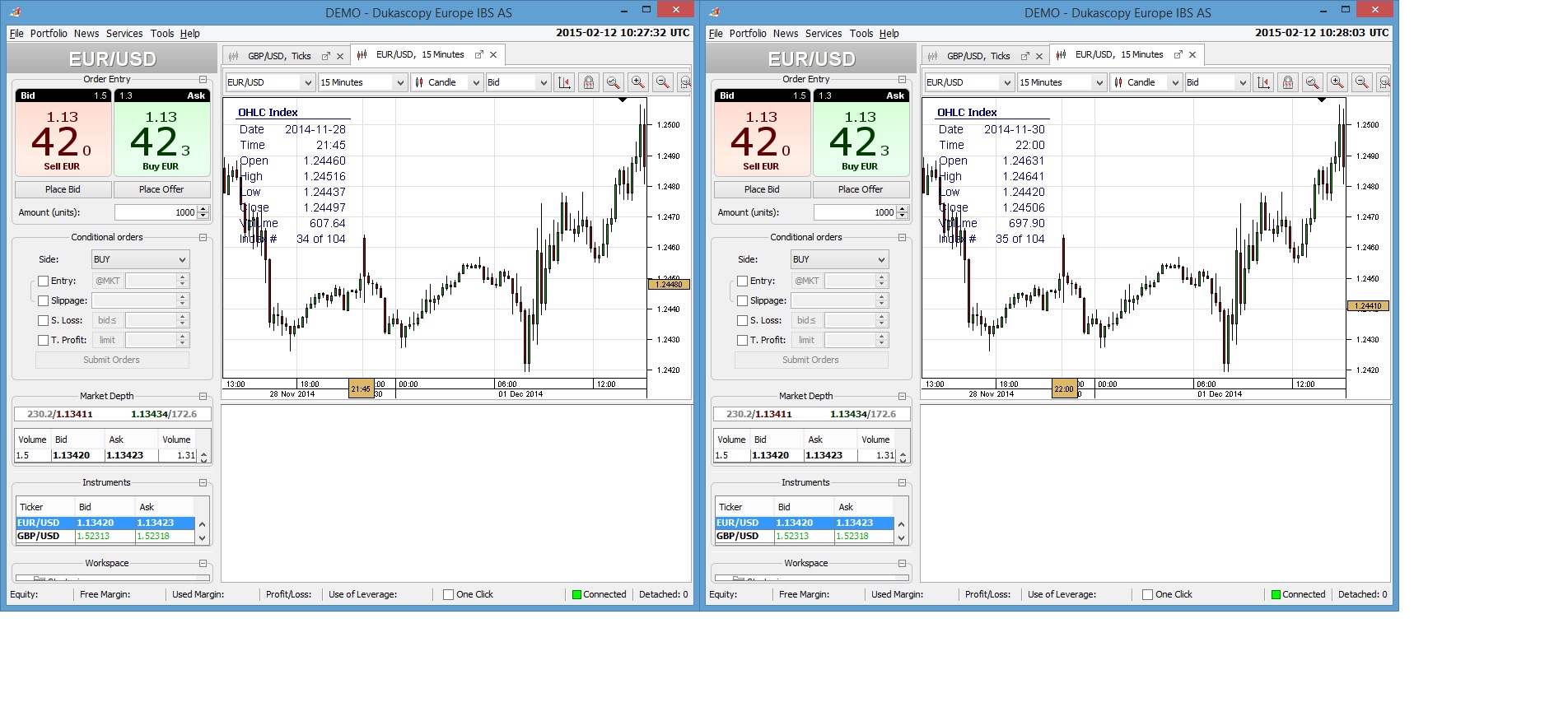

Attached is a screenshot from Dukascopy's own JForex platform showing the same day you mentioned. As you can see from the two screenshots, the last bar for 28th November 2014 is 21:45. The next session starts on 30th November at 22:00. We have also confirmed this from the raw historical data files that Dukascopy is delivering. You can also confirm yourself by going to the directory:
<StoreLocationFolder>\AUDUSD\2014\10\28 (the "10" represents November as the numbering is zero-based)
and noting that the 22hr and 23hr files are empty which means no trading is occurring at those times.
If you are getting additional data from other programs it is possible that it is being padded out by flat bars.
Hope this answers your questions.

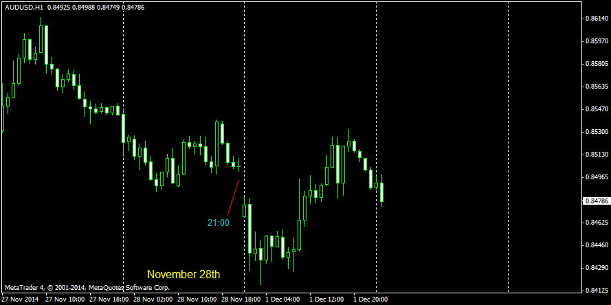

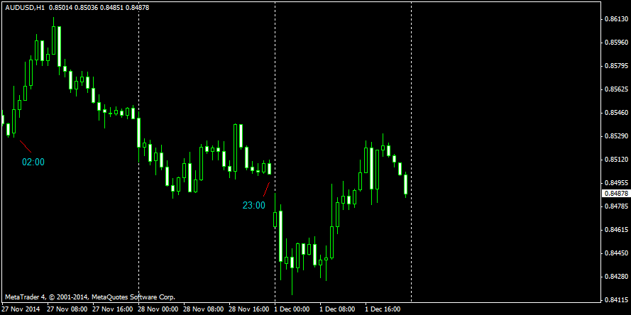

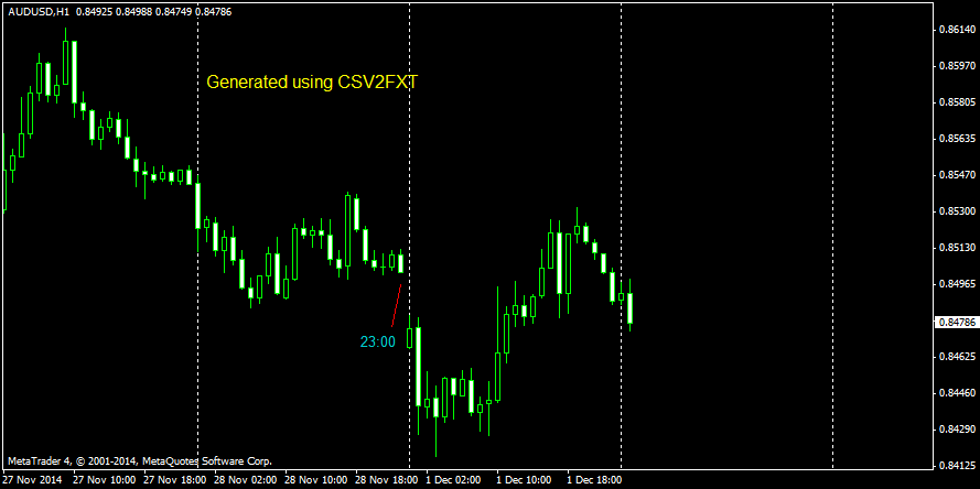

Dear ticktory
Dukascopy's data timestamp is in GMT, and the broker which I export the data into, uses GMT +2. So if last bar of Dukascopy is 21:00 the exported bar should be 23:00. And those bars 22:00 and 23:00 in dukascopy data which are empty, are shifted into Saturday 00:00 and 01:00, when the market is closed, so they are empty.
Here I compare three different charts for 2014 November 28th. First chart shows the exported data using tickstory; second one shows CSV2TXT generated export and last one shows the broker's own data.
1. Tickstory
2. CSV2FXT (I used a CSV file generated by tickstory and then exported it into Metatrader using CSV2TXT)
3. FxPro's own data
As you can see, in all 3 charts all other bars are the same, except for last two bars of Friday, which tickstory misses to export.
Re: Different results
Hi Rpg,
Thanks for the further information. The reason why those bars are missed is due to the weekend-filter which essentially filters all data after what it considers the close of market (which in Dukascopy data is Friday 22:00h). We can see the issue that it could cause for you and will try address it with a few more options. I believe the original reason for the filter was there was some "extraneous" tick data in the Dukascopy feed occurring after market close that was causing an issue for some users. For the moment, you should be able to "include weekends" which should reveal those missing bars in the exported data.
