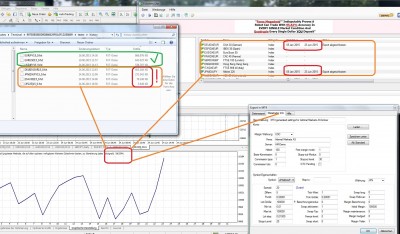

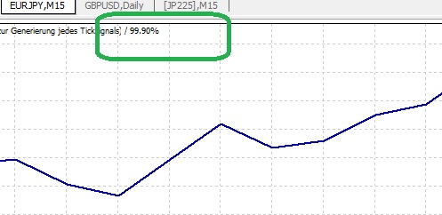

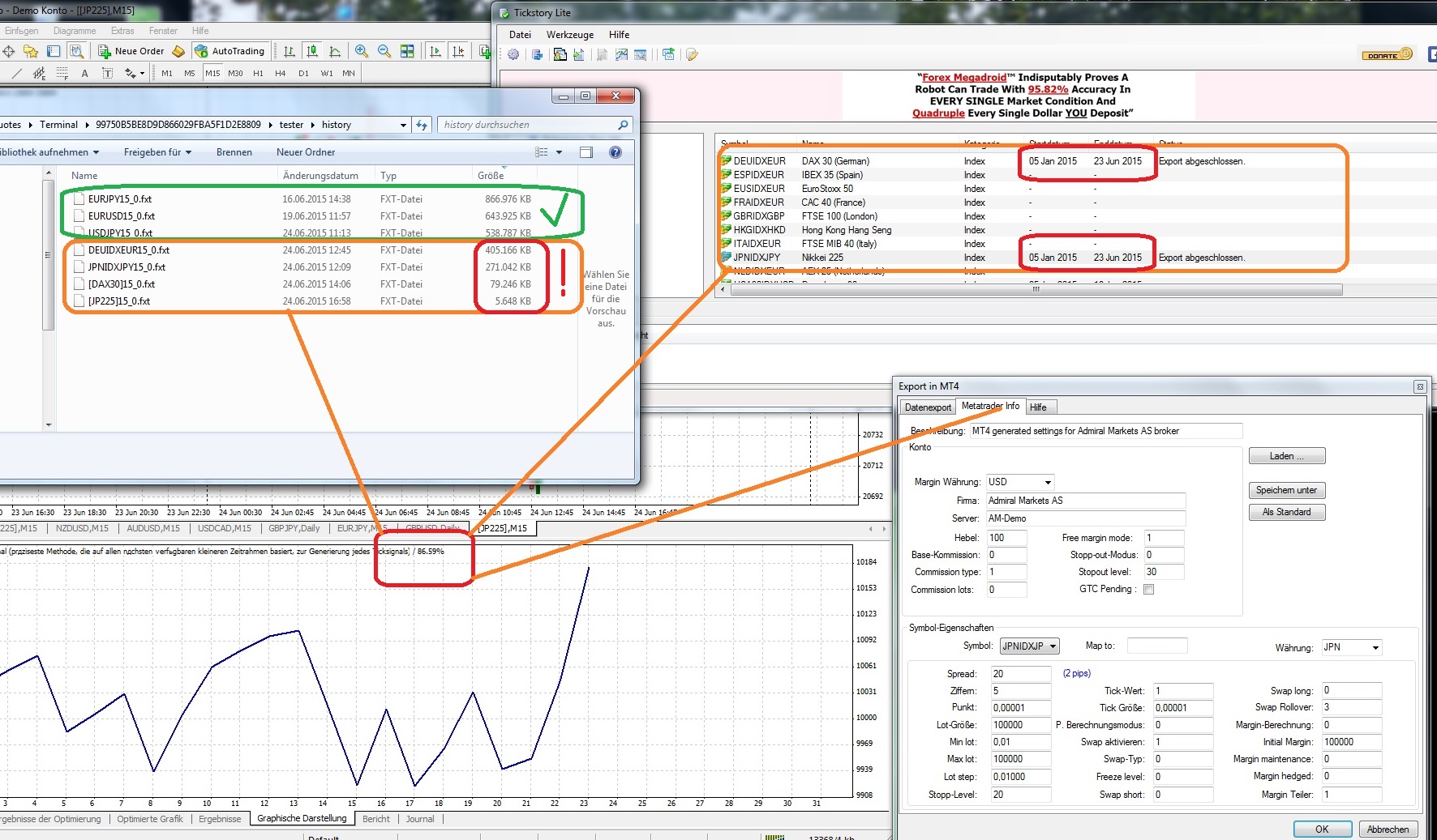

there is no error message, the file is loaded, but is incomplete.
quality for 4 weeks and only 86%.

I've read the FAQ, it does not affect my problem.
I can accessible by all other instruments 99% quality.
This means that the settings are correct.
ONLY with INDEXES cannot get the quality.

Re: indexes
Hi - You will note that the symbol name in Dukascopy is "JPNIDXJPY" whereas your MT4 symbol name is "[JP225]" (note the braces). You will need to use the "Maps To" field to map the Dukascopy symbol to your MT4 symbol name. This process is described in the manual and also if you search the forum for "Maps to".

Thank Tickstory team, that was the crucial clue.
Now everything works.
