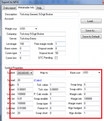

Hi support team, is the setting ok with dex30?
or i need to change point from 0.00001 to 00000.01? or just leave it normal?

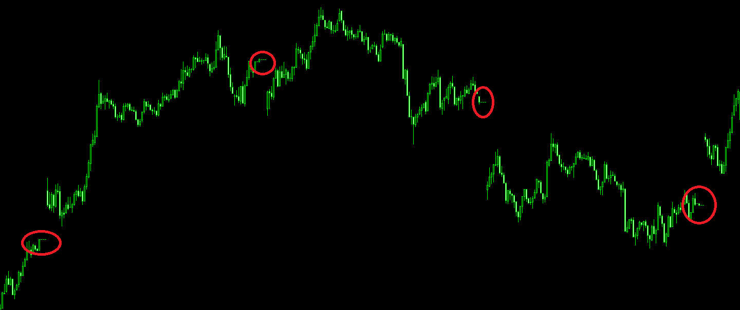

i am so sad with this 99.9% tick data... please help, what happen with this :(

- Yes, you will need to map DEUIDXEUR to german.cash (i.e. the exact naming, case-sensitive). This topic is covered in the manual along with number of threads in the forum (see http://tickstory.com/forum/search.php?k ... c=1&sf=all).
- For the DAX settings, see this thread which describes how to get your DAX settings along with an example setting that you can use to get up-and-running: http://tickstory.com/forum/viewtopic.php?f=2&t=809.
- Regarding the data, it is most likely that you have chosen to "filter weekends" and also apply a time-zone shift. I would export as GMT and/or with weekend data until you get more comfortable with what data is available.

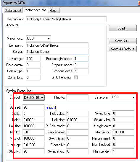

Hi tickstory support team,
I am using squaredfinancial broker, the website is http://squaredfinancial.com/
I have problem setting with my dax30, can you please help me find out the right config setting on dax30( GERMAN.CASH) with this broker ?

Hi Wenn,
As previously mentioned, please take the time to read through the instructions in this post to get your settings:
